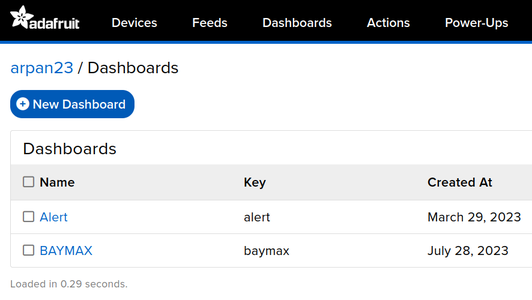

1. Click on Feeds from the top bar and select New feed. Give a name to your feed. I would suggest you to use the same name I have used, “BAYMAX”. This will make life easier during programming.
2. Click on Dashboards from the top bar and select New dashboard. Give the same name as your feed.
3. Click on the dashboard you created and select the gear icon on the right. Then select “Create a new block” and select the Gauge.
4. Now select your feed name (BAYMAX in this case) in the popup window.
Then click on the next step. In the next window, don’t change anything. Just click “create block
5 .Now your block is created. Click on “My key” on the top bar and note down your username and active key. This is unique to your project and make sure not to share it with anyone (Unless you want them to mess with your project that is)

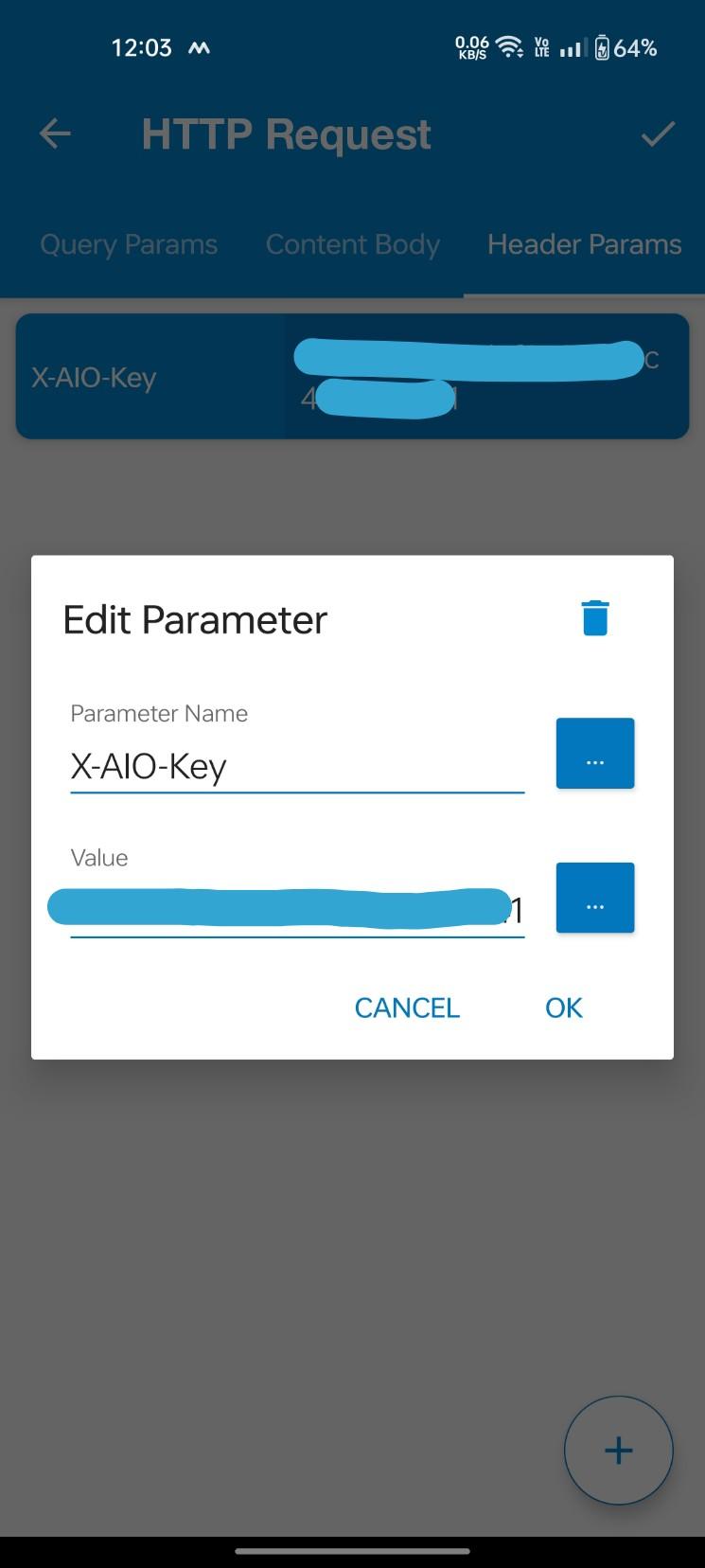

  6. Go to the Content body tab and select application/json in the content type. Type {"datum":{"value":"0"}} in the body.
  7. Next, go to the header params tab. Click on the + and type X-AIO-Key in the parameter name. In the value section, enter the active key you noted in your adafruit dashboard.
And we are done! Save the macro and close the app.

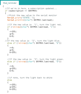

I have attached the arduino code at the end of this step. Once you double click on it, you might get a popup asking you to put it inside a folder. Just click 'OK' and it will do the job and open up the code in the Arduino IDE. There are few changes you will have to make though.
You'll have to add your Wifi SSID, password, adafruit Active key and Username in the necessary fields. Everything is labelled properly, so it should be easy to find them.
In my code, I have added colors for 3 medicines. Medicine 1 is assigned red, Medicine 2 is assigned blue and medicine 3 is assigned green. And when the input is 0, I have assigned white color as a default value. In case you would want the light to be off by default, in the last else block, replace all the three 255 with 0.
The rest of the code has to do with connecting to Adafruit and Wifi network, and everything is labeled well, so it should be easy to understand.
