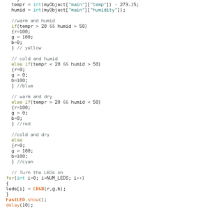

The code uses the FastLED library to control the WS2812B strip.
First, you need to make a few changes in the code so that it works as intended. I have added arrows wherever you will have to make changes.
  1. Add your WiFi SSID and password in the necessary fields.
  2. Provide your Open weather API key in the next field.
  3. Add your city and country codes in the next two sections. This will help Openweather send the weather for your location. If this doesn't work, you can try replacing the city name with your zip code. You can find more details here

The code extracts weather data using OpenWeatherMap API. Then we parse the JSON response from the API to get two main details: Temperature and Humidity.
By comparing these values, we determine how the weather is and display the right color on the LED strip. For example, if it is very cold and humid, we display a blue color.
