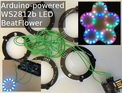

So for our tests for now we just need the first three pins. I soldered all of them anyway, as you can see on the picture. For testing purposes, I connected it to my ATmega2560 (see pictures). Connect 5V and GND to the respective pins on your ATmega (or equivalent) and use this code for testing it. I configured it to use pin 5 on the ATmega, so if you don't change it in the code, connect your DI to your pin 5 as well.

As you can see on the pictures, I daisy-chained the five LED rings. As mentioned before, the output (DO) of one ring goes to the DI of the next. The first DI is fed directly by the ATtiny85. An important thing to note here is that the physical pins on the controller and the software pins you define in your code don't follow the same numbering. This article has a great schematic picture of it. So right now I'm using the software pin P0 (physical pin 5) as the output line. The Digispark actually has the software pins written onto its PCB to reduce confusion.
Besides DI and DO, you have to connect all 5V pins and all GND pins on the rings. Once you've done that, you're set. If you want to test this, you have to change the NUM parameter in the test code from 12 to 60 (5x12) so that the NeoPixel library knows what to send. If everything lights up as expected, you're good to go.

To assemble the lights onto the front plate, simply push the longer 8mm screws through the holes, directly attach the LED rings onto them using the mounting holes, and put a nut on each.
Each LED ring has two mounting holes and all in all you'll have to attach ten nuts. The best is to arrange them in a circular, clock-wise order, starting with the top one (if you look at the front plate's shape, one sticks out; this is the top). This way, your design will be best compatible with the code I'm supplying for actually using it later on (in terms of numbering the rings when accessing them software-wise).
Also, the LED rings have four mounting holes. Use the outer two; this means, the cables go towards the center of the acrylic plate and are on the opposite side of the mounting holes you use. See the pictures for details.

After having fully assembled the front plate, we're going to fix it onto the back plate. In the first picture, you see how the nuts will be aligned. They will be fixed to the back plate using the 5mm screws.
Here is something I encountered because I haven't thought about it before: Neither the Digispark nor the connector I soldered to the wires fit through the hole in the back plate. I had to unsolder and resolder the cables in order to bring the cables through the hole.
After doing that, screw the nuts (that are currently on the front plate) to the back plate. It only fits in one way due to the one leaf of the flower sticking out. After assembling this, try the lights - it should resemble what you see in the video.
