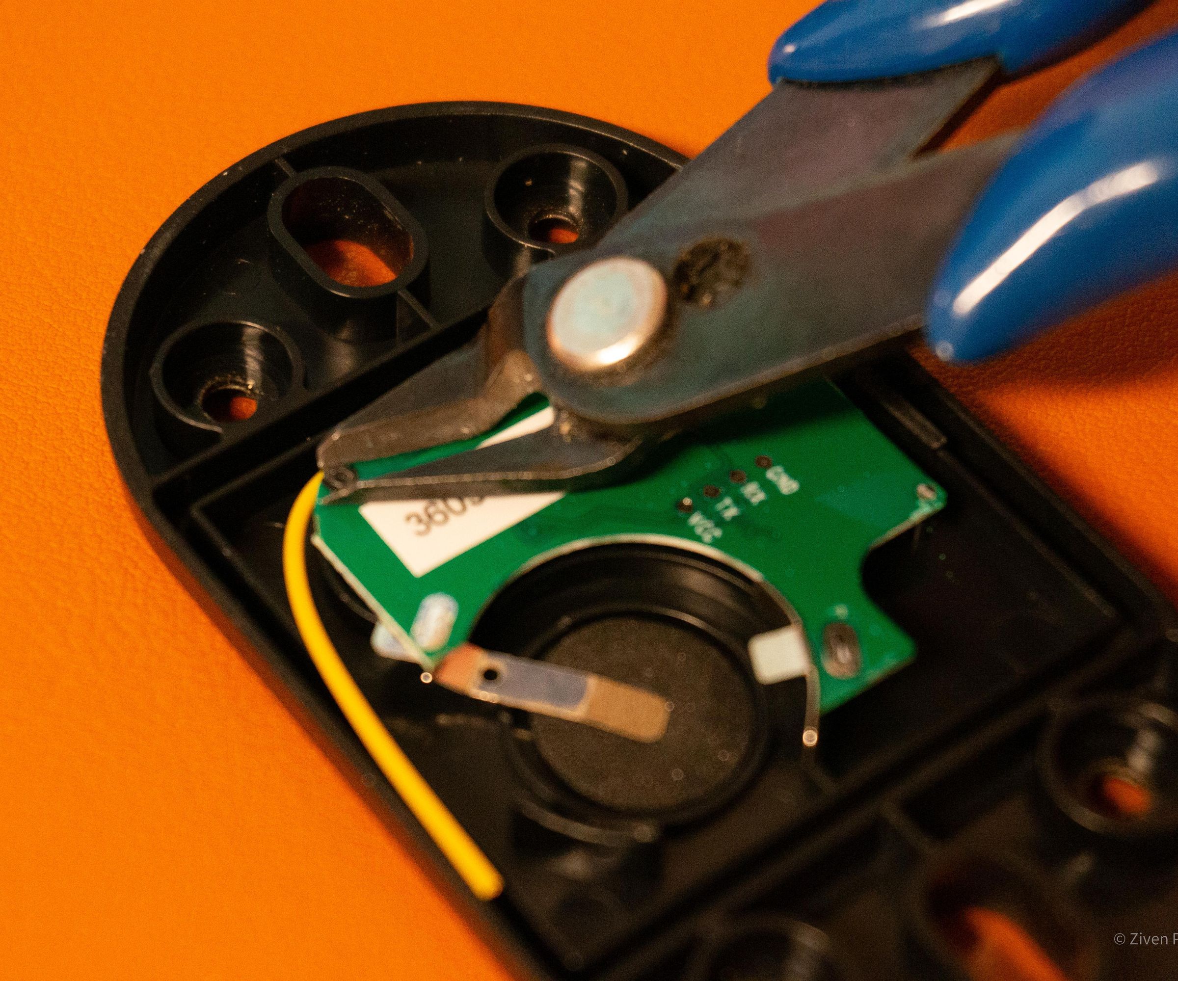

After getting the Atmega ready, it is time to test everything. Put together the parts on a breadboard. This is a crucial step to ensure success. The images are some of the resources I used and the prototypes I made.

I did not have a 28 pin IC socket. So I made my own. I started with two 16 pin IC sockets and cut the end off of one. I cut off the last 4 pin holes to minimize size. After reducing the size to match the Atmega 328, I removed the pins that I did not need. My reasoning behind this was to reduce errors. I surface mounted the chip, and if there were a bunch of terminals laying around it could short circuit.
