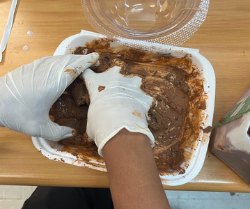

mix your clay with water to the right consistency

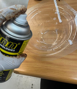

spray release agent onto your vacuum formed mould of choice
Step 3:
Start moulding into your mould master

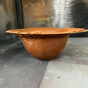

leave to dry for 3 days

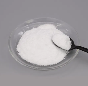

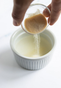

mix your gelatin ,water,glucose powder with water

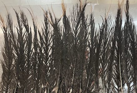

spread mixture all over the feathers put in line on a plastic and leave to dry for 3 days

remove the dry clay from mould & assemble
