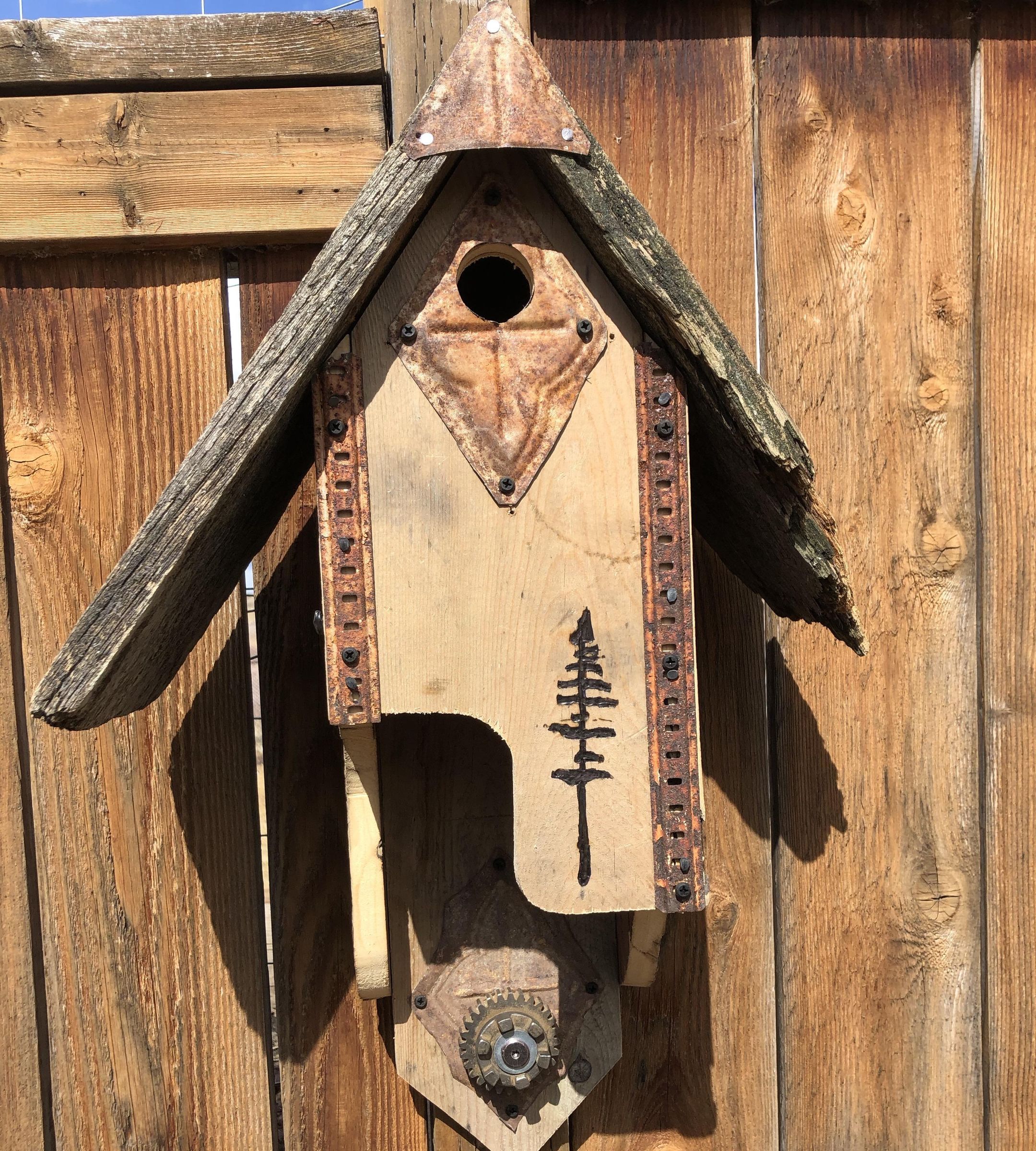

Step 8: Personalizing the Birdhouse Planter
In order to make the birdhouse planter more attractive and unique, I trimmed the birdhouse planter with a variety of rusted metal materials. As shown in the pictures, I attached gears in a couple places to add some character to the birdhouse. These rusty materials can be found at salvage yards or transmission repair places. (Be prepared for strange looks from workers when you ask if they have rusted metal materials).
Attaching these gears can be difficult to do. One of the gears was exactly 1.25”, so I drilled a hole and inserted it into the front panel. The other gears were attached by drilling holes in the metal and screwing them to the birdhouse. To trim the birdhouse, I used rusted metal banding and rusted shelving brackets that I found in the salvage yard.
The grey corner covers and center pieces were cut from metal siding panels that I collected from a local grain elevator office that was being destroyed. To attach these pieces I used small black screws.
Step 9: Close Ups of the Trim
Adding the rusted metal pieces to the birdhouse is probably the most interesting and fun part of building these birdhouses. I have made 4 of these birdhouses so far, and each one is completely unique.
I plan on making a few more for family and friends. If you choose to try this instructable, I hope you enjoy it as much as I do.

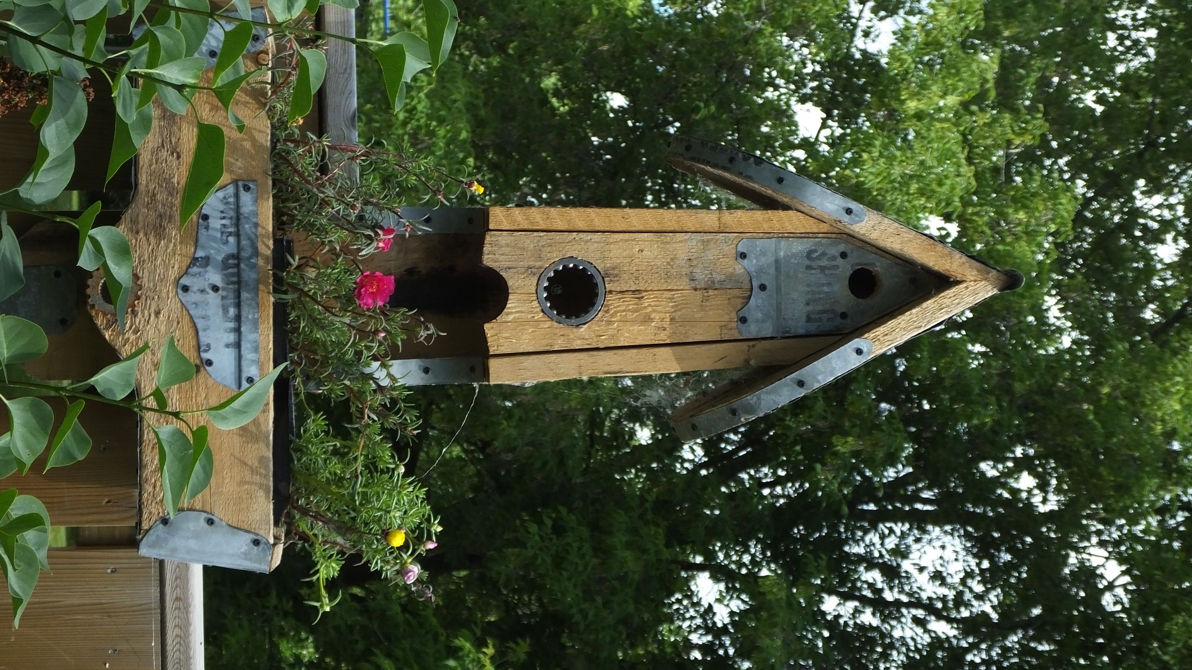

Step 11: Adding Plants to the Planter
Where I live, it is too early to put real plants in the planter. The over night temperature can dip below freezing. So, for these pictures, I put an artificial plant in the planter to demonstrate what the birdhouse planter could look like with plants.
The planter is designed to hold three or four 4” plant pots. This makes it easy to put plants in the planter, and allows for easy clean out.
