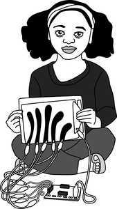

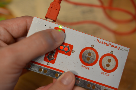

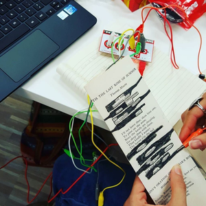

  2. To do this, you'll need to understand how Makey Makey works! Take it out of the box and plug in the red USB cable. Then using your hands, hold EARTH and press any of the inputs on the front of your Makey Makey. (Up arrow, down arrow, left arrow, right arrow, space, and click.) Picture 1

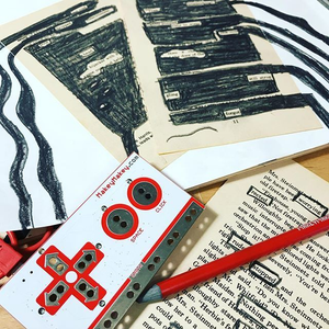

  3. You can extend any of these connections by plugging an alligator clip into the silver spots, and even extend it further by drawing with graphite! (aka pencil lead!) Just make sure that you make your drawing thick with graphite and that you make boxes around your words, but keep the drawings from touching like in Picture 2.
  4. You can then alligator clip directly to your drawings. You may want to use an index card fr stability or you can put your drawing on a clipboard and use the metal on the clipboard for your EARTH connection like in Picture 3.
  5. The best thing about drawing your circuits is that you can erase your mistakes! Watch this student troubleshooting. Or watch the whole video tutorial here.

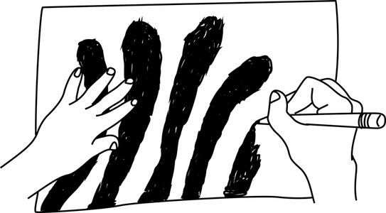

  6. You will make a voice recording for each black out drawing. So make sure you draw around clumps of words you want to be read together, or even around "stanzas" of your poem. See the example in Picture 4.

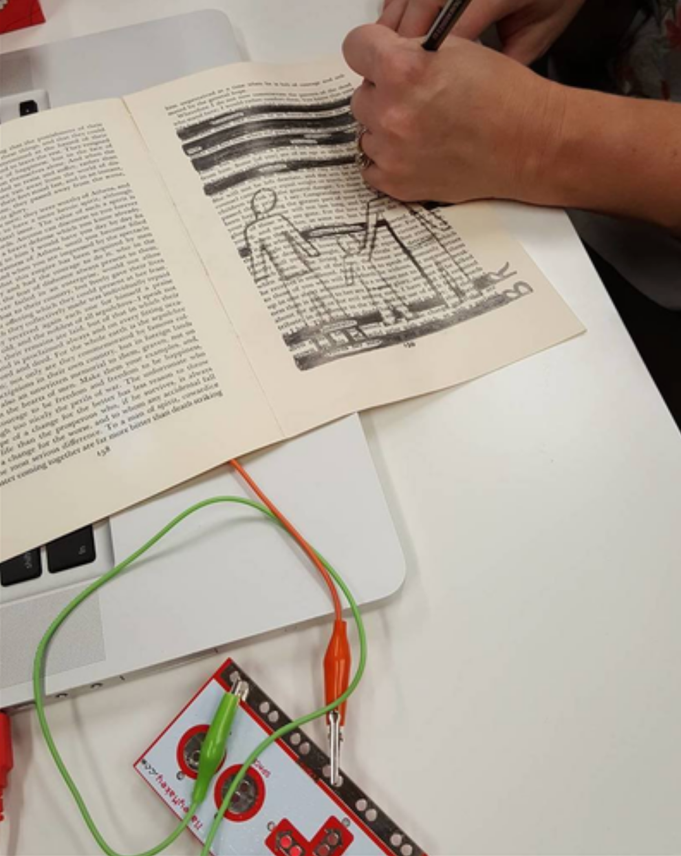

More advanced blackout poetry: In the second half of the video, you can see my more advanced circuit drawings. I gluesticked my poetry pages to a sheet of paper and drew my circuits so that it looked more like abstract art. To connect the drawing from one page to the next I added conductive tape like a patch or a bridge. Without the tape, my circuit would only close on the white paper. The tape helps the electrons flow to the rest of my black out boxes on the book page. It helps to test your circuits as you are drawing. I don't do any coding or go to any specific webpage. Instead I just turn my computer on and plug in the Makey Makey to see if the lights are lighting up when I touch my drawing.

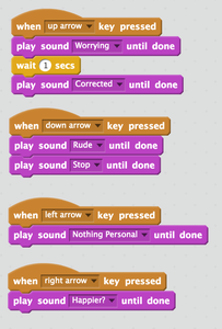

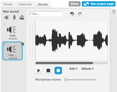

  • Scratch 2: For each recording, Record your voices in Scratch by clicking on the "Sounds" tab and clicking the microphone to record see Picture 1 and Picture 2.
  • Scratch 3: In Scratch 3, you will still navigate tot he Sound tab, but you'll see the "add sound button" is a blue circle on the bottom. You have more choices for editing your sounds in the new Scratch! It even automatically looks for quiet parts to edit. Drag the red bars to where you want your sound to start and end like in Picture 3. Then you'll have some editing choices like in Picture 4. I used the "slower" effect to make my voice sound like someone else! The echo effect sounds really neat too.
