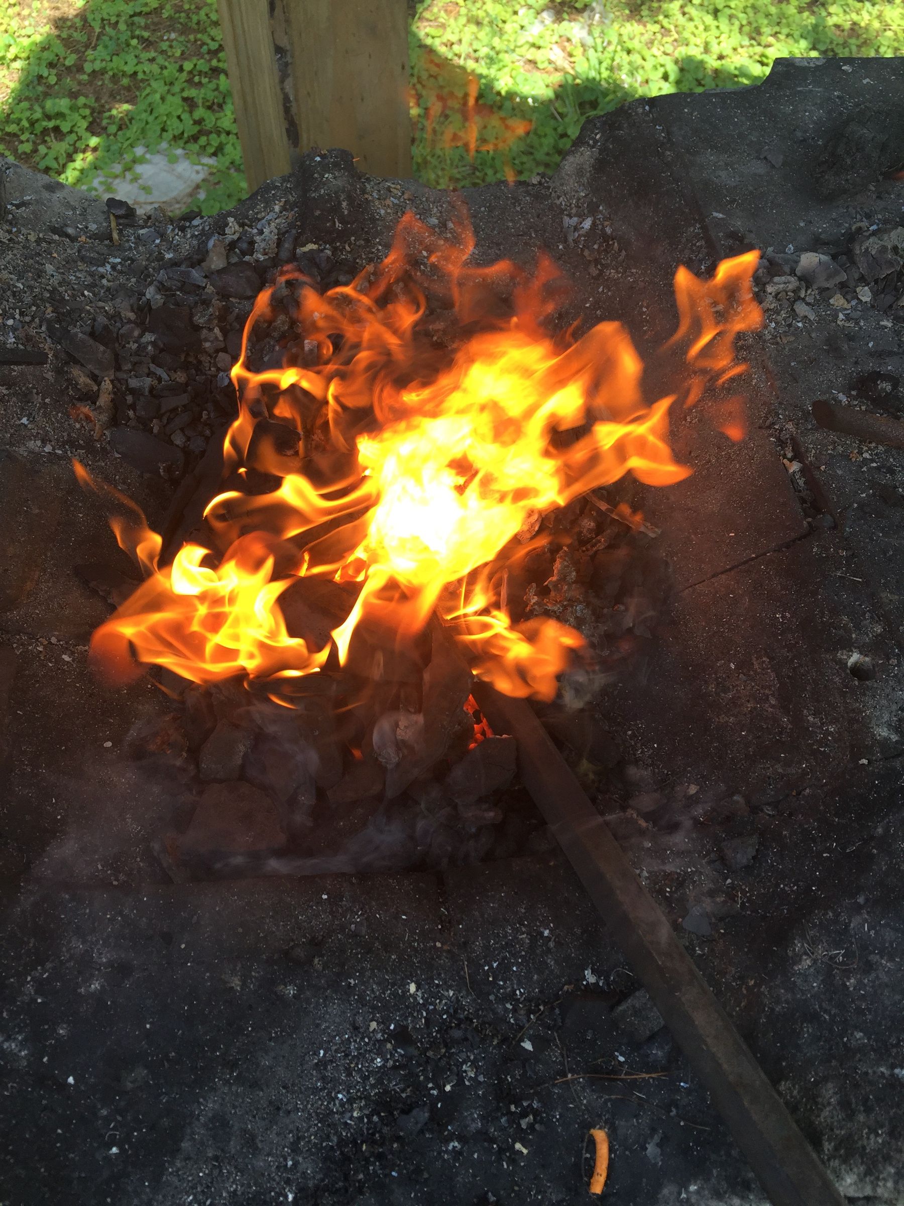

Step 2: Start Forging Things Into Shape.
Step 3: Start Welding Things Together
Step 4: Go Crazy in Regards to Aforementioned Welding.
