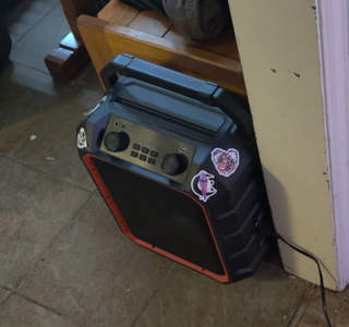

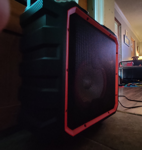

Most wireless rechargable bluetooth speakers follow a simple schematic including a case, speaker/speakers, 1-3 circuit boards, and a standardized battery and power circuit. When my girlfriend's Blackweb BWA18AA014 rechargable suitcase speaker became tethered to the wall outlet for power, I knew there may be a solution to restoring its ability to hold a charge.
With a few pretty standard tools and a little insight and research, I was able to restore this to a relatively impressive battery life of 8-9h at medium-high volume instead of seeing it added to e-waste bundles and waste money on a new speaker.

On this speaker in particular one center screw is hidden behind this panel (almost found out the hard way). It is a hard plastic and is adhered to the speaker, but came off without a trace. I also found out the original plastic was accidentally left on it, to my relief.
It took a good bit of working with it before it began to give, but once it gave it peeled off with little force. Other models/brands may have other caveats and hidden screws so if the lid isn't giving and doesn't show any signs of glue or anything, feel around where it's getting held on for any other possible screw covers/panels that can expose remaining screws/fasteners.
