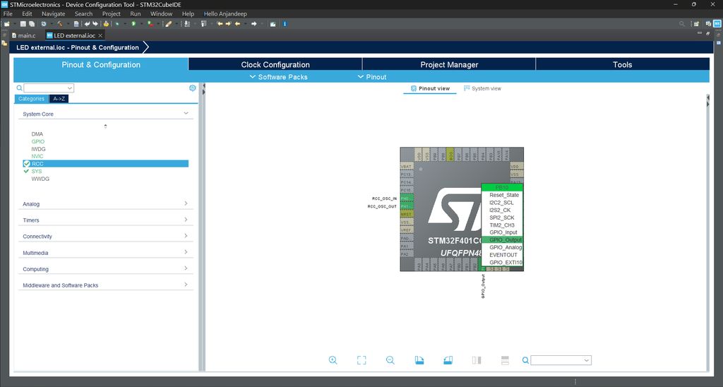

Step 3: Select Pinout and Configure Clock

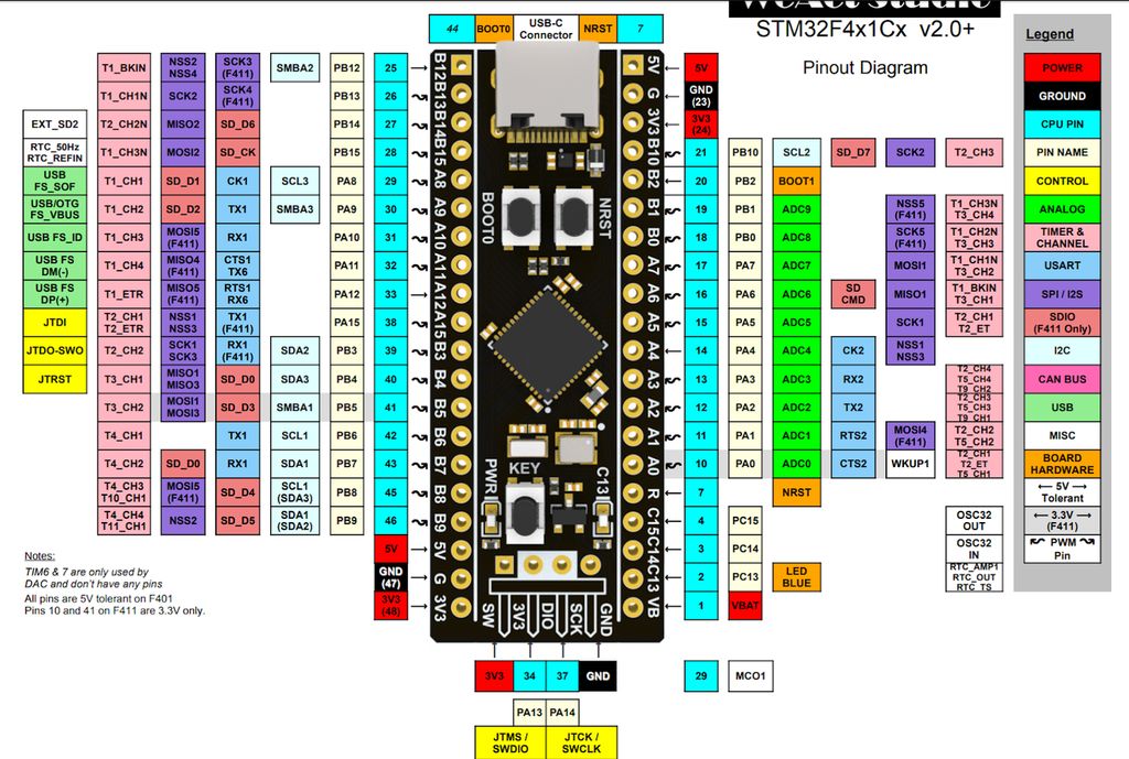

  • Check any GPIO pin in the pinout view. Refer the attachment of STM32 Black Pill pinout.
  • I have chosen Port B, pin number 10 [PB10].
  • I used the default clock for this task.
  • Press Ctrl + S or Alt + K to generate code.

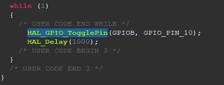

Step 4: Write Code

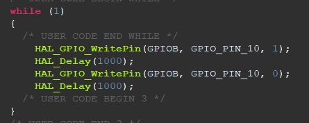

  • Open "main.c" file.
  • Go to line 95, in "while(1)" write the code to send a HIGH [digital 1] output, then add a delay and send a LOW [digital 0] output to the LED.
  • Your code should look something like in the attachment.
  • You can also use toggle function.
  • Finally, press the debug button from the menu bar or use F11 shortcut key.

  • As I chose PB10 for GPIO, I'll connect the +ve terminal of the LED to it.
  • And connect -ve terminal of the LED to GND. You can check the pinout of ground from attachment shown above.

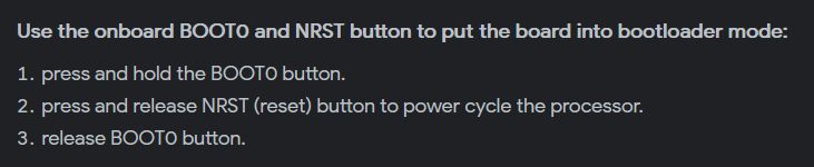

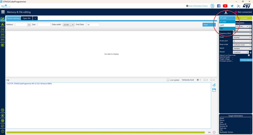

Step 6: Setup STM32CubeProgrammer
  • Choose USB as the connection method. [This tutorial does not use ST-LINK.]
  • Enter boot-loader mode by the steps in the attachment. Refresh until it shows up and press "Connect."
Your STM32 board should show up in the device manager under Universal Serial Bus devices if done correctly.

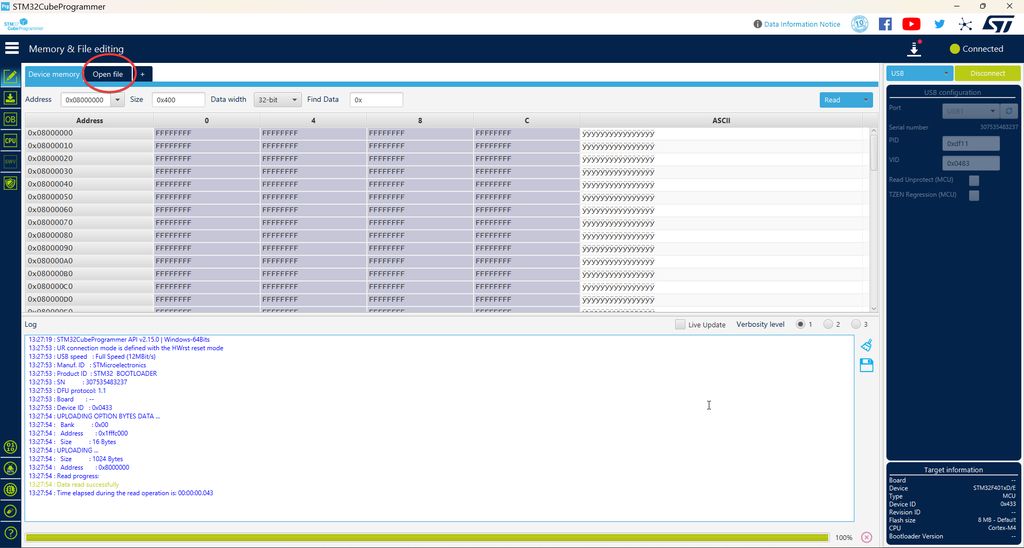

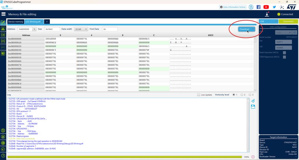

  • Press on "Open file" and choose the .elf file from STM32 project directory.
  • Press download.

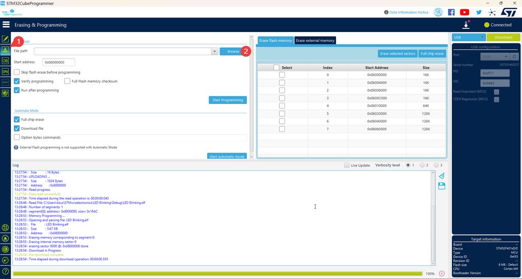

  • Go to the download icon from the menu in the left and press browse. Again select the .elf file.
  • Once done, check the options as shown in the attachment.
  • Finally, press on "Start automatic mode."
  • Once a message saying "Please disconnect device n:1 and connect the next..." shows up reconnect your STM32 board.
