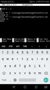

Step 5: Termux Example
Let's continue with simple example with Termux. It is again simple loop which writes '0' and '1' to file.
You can use Python or any other favorit programing language running in Termux to control Arduino and make amazing projects.
Of course you can read data from Arduino simply by reading rx.txt file.
<p>while [ : ]<br>do echo "0" > ~/storage/shared/btspp2file/0/tx.txt sleep 1s echo "1" > ~/storage/shared/btspp2file/0/tx.txt sleep 1s done</p>
