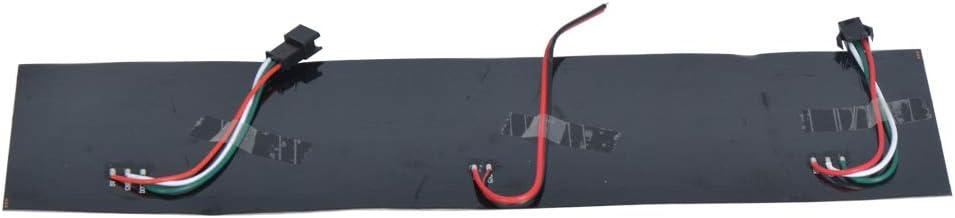

Step 3: Solder Wires to LEDs
  1. Solder two lengths of 22 AWG wire to the +5V and GND terminals of the LEDs. These are the two wires seen in the middle of picture #1 above. We are replacing the wires that come with the LEDs with longer wires to fit our requirements.
  2. Splice dupont wires onto the LED data wires as shown in picture #2
  3. Be sure to add tape or heat shrink to the spliced wires to avoid shorts! We recommend heat shrink with electrical tape as a second option. Although we used scotch tape as it was what we had on hand.

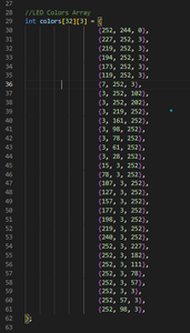

Step 8: Change LED Colors (Optional)
Just like in Step 7, if we go to the Bluetooth Speaker folder that was cloned from GitHub, open the components folder, then the leds folder and then in the leds.c you can alter the array shown in the picture above from line 29 to 61 to change the colors used in the LED array. These seemingly arbitrary values are the RGB values of the LED matrix. We recommend using a google RGB color picker to find values if you choose to change them.
