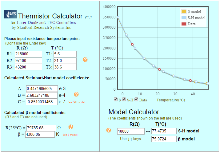

As common as the Extech probe is, the Steinhart-Hart coefficients aren't published anywhere that I could find. Fortunately there is an online calculator that will determine the coefficients from 3 temperature measurements you provide.
http://www.thinksrs.com/downloads/programs/Therm%2...
What foillows is the basic procedure I used to arrive at the coefficients. Won't earn any points for style but good enough to get you to say +/- 1 degree accurate (a total thumbsuck on my part) .... depending on the accuracy of your reference thermometer and multimeter of course! My multimeter is a cheap no-name brand unit I bought many years ago when money was tight. Money is still tight and it still works!
To calibrate, we need three resistance readings from 3 temperatures.
- Near freezing by adding ice to a glass of water and stirring until the temperature stabilized. Once stabilized, use the multi-meter to record the resistance of the probe and the reference thermometer to record the tmeperature..
- Now place the probe into a glass of water at room temperature, allow the probe to equalize with the water temperature and record the temperature on your reference thermometer and the resistance reading on your multi-meter.
- Place the probe into a glass of hot water and record the resistance.
Temperature Resistance 5.6 218K 21.0 97.1K 38.6 43.2
This whole process is a bit of a chicken and egg situation since you need a calibrated thermometer to record the temperature and a calibrated multi-meter to record the resistance. Errors here will result in inaccuracy in the temperature measurements you make but for my purposes, +/- 1 degree is more than I need.
Plugging these recorded values into the web calculator yields the following:
The coefficents (A,B and C) are plugged into the Stenhart-Hart equation to deterrmine the temperature from a sampled resistance value. The equation is defined as (source: wikipedia.com)

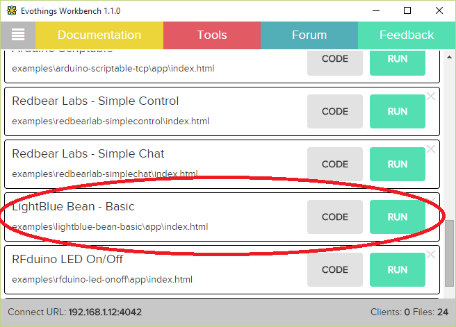

After you have installed the EvoThings Workbench, you will find the Lightblue Bean example here (on Windows 64 bit computers):
ThisPC\Documents\EvothingsStudio_Win64_1.XX\Examples\Lightblue-bean-basic\app
You can replace the index.html and app.js files with the files attached to this step. The changes made to the jacascript file extract the 3 floating point temperature values form the scratch data area, and up the the inner HTML of new elements created in the HTML file.

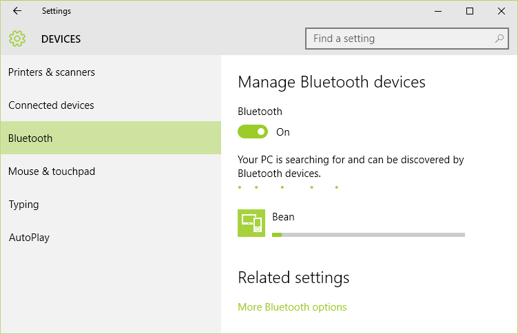

Step 7: PC Settings and Bluetooth Configuration
The firmware build and upload cycle for the Bean is all done over Bluetooth. There can only be one active Bluetooth connection at a time. The Bean Loader is available from the Windows App Store

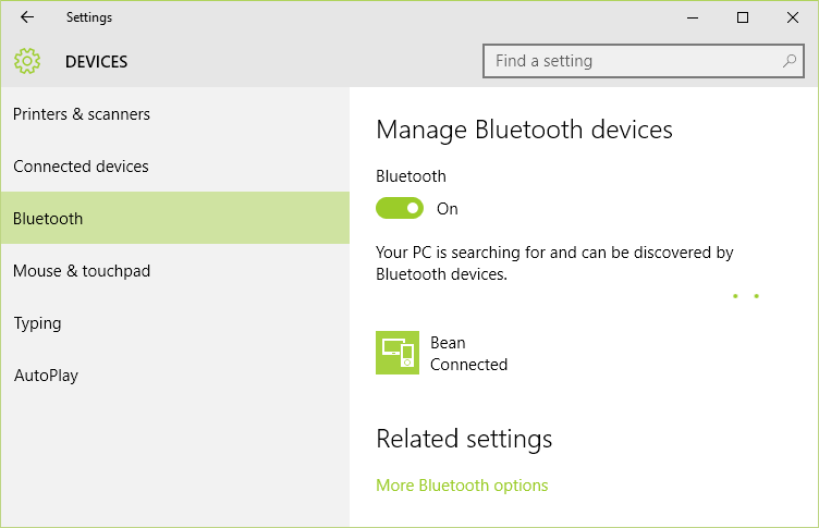

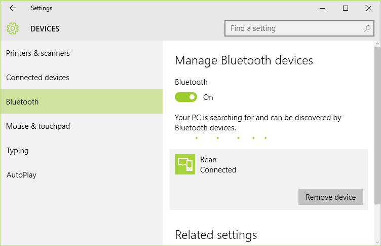

The basic cycle I use to pair and connect ( and repair and reconnect when things go wrong) is as follows: From the Control Panel;/Bluetooth settings, you should see the following screen:
Eventually windows will report "Ready to pair". At this point you can click on the Bean icon and after some seconds, Windows will prompt you to enter a passcode. The default passcode for the bean is 00000
If the passcode is entered correctly, Windows will show that the device is properly connected. You must be in this state in order to be able to program the Bean.

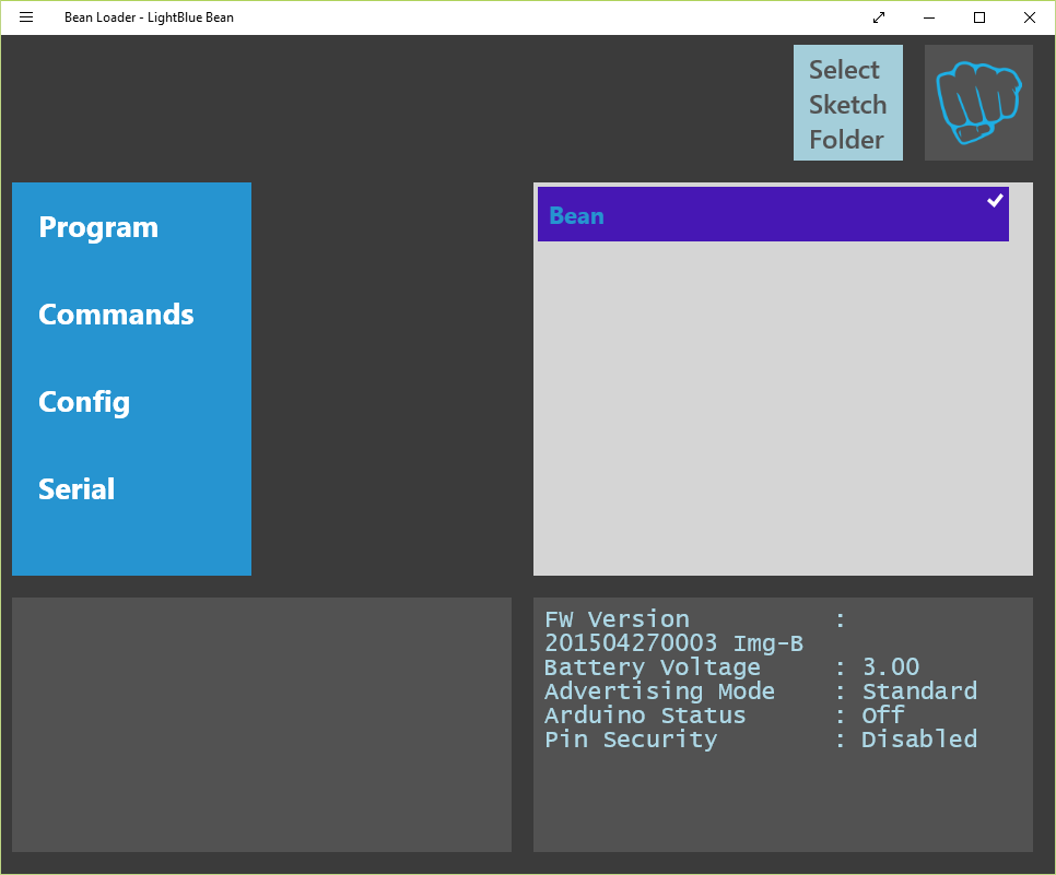

Once you are paired and connected, use the Bean Loader to load the firmware to the bean. I found this to fail more often than not and it appeared to be related to proximity to my computer. Move the Bean around until you find a location that works for you. There are times when nothing will work and the Bean Loader will suggest re-pairing the device. Typically going through the pairing process again will restore connection. You must "Remove the Device" before re-pairing.
The Bean Loader operation is straighforward and well documented on their site. With the Bean Loader open, choose the "Program" menu item to open a dialog to browse to the Hex file provided in the firmware step of this instructable.
Once the firmware is loaded, CLOSE the Bean Loader so that the connection between the Bean Loader and the Bean hardware is dropped. You can only have one connection at a time. Now open the EvoThings workbench and start the EvoThings client on the smartphone or tablet.
When you click the "Run" button, the EvoThings client will automatically load the html page for the thermometer. Click the Connect button to connect to the Bean and you should see temperatures displayed. Success!
