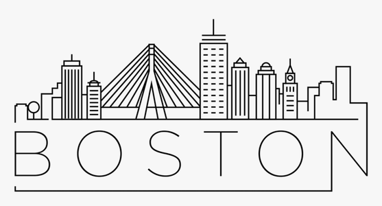

establish an image to utilize in this project, and prepare it in Adobe illustrator.
Step 2:
Laser cut the design along with a corresponding stand. When designing the stand be sure to carefully choose the angle at which you would like it to stand.
