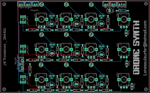

The board is actually 2 sided. On one side are all of the components like capacitor, resistors, transistors etc. On the other side are the potentiometers and switches.
Due to the size limitations on circuit design in Eagle (100mm X 100mm) I had to jam a lot onto a small sized board. However, you can make the board bigger to add screw mounting holes so the actual size is ...
The oscillators are lined-up in 3 rows of 3 for a total of 9. I've also added tone pots for each row and there is also a master tone pot. There is a on/off switch for each row so you can turn each one off when tuning.
If you would like to play around with the schematic and board in Eagle, well I have also provided these in my Google Drive. You can also find a PDF of the schematic in this step.
There are actually 2 versions available of the PCB. Both are available in my Google Drive
Version 1
This is the one I used ion this build. It has a tone pot for each line of drones (3) plus a master one. I don't use the tone pots very often so decided to do a version 2
Version 2
This has the tone pots removed (only has the master one) and an extra drone circuit for a total of 12 drones!

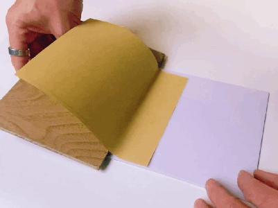

  2. The front panel needs to be printed on clear, adhesive paper. You can get this from eBay and have added a link to the parts page.
  3. Cut out the image and carefully place onto the opal acrylic and remove any air bubbles. I peal away the top section and lay this onto the acrylic. I then use something flat like a ruler and carefully run it down the adhesive paper to ensure no creases or air bubbles are introduced.
