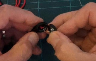

  1. Open up the ear pieces
  2. Unsolder the leads from the speakers and check speakers are OK
  3. Swap the new lead over (undoing and redoing the small knot)
  4. Solder the new leads in place
  5. Reassemble the earpieces.

Open up the earpieces:
This tends to be easier than it might first appear. There is usually a joint between the main body of the earphones and the cover over the speakers. Pressing a moderately sharp blade on this joint will often open it. Try applying a small force sequentially around the joint, gradually increasing the force until it gives way. Keep flesh the right side of the blade!
My Sennheiser phones were just clicked together. No glue, and clicked back just as easily.
Unsolder the leads from the speakers and check speakers are OK:
Before unsoldering note the lead colours and if there is a polarity marked on the speakers. This is usually a red spot. If possible check which is ground using a meter to the barrel of the plug. Note also that the plug tip is left and the middle-ring right.
Also check the resistance of the speakers. They should be around 16 - 64 ohms. Most earphones are 16, 32 or 64 ohms. If they are outside this then check their specification. If one speaker is different to the other and different to the specification then there is probably a fault and best not to use it. If it is lower than 16 ohms there is probably also a problem and I would check it this should be the case and whether the player is rated to drive the lower resistance.

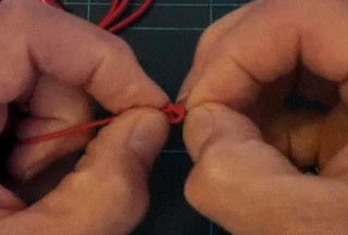

Swap the new lead over (undoing and redoing the small knot):
There is usually a simple knot to restrain the lead. Undo these and swap the leads over. Use a meter to check the right and left are the correct way around (or just move them over one at a time). Then redo the knots. The leads tend to retain their shape and so it is easy to get these made in the original places.
