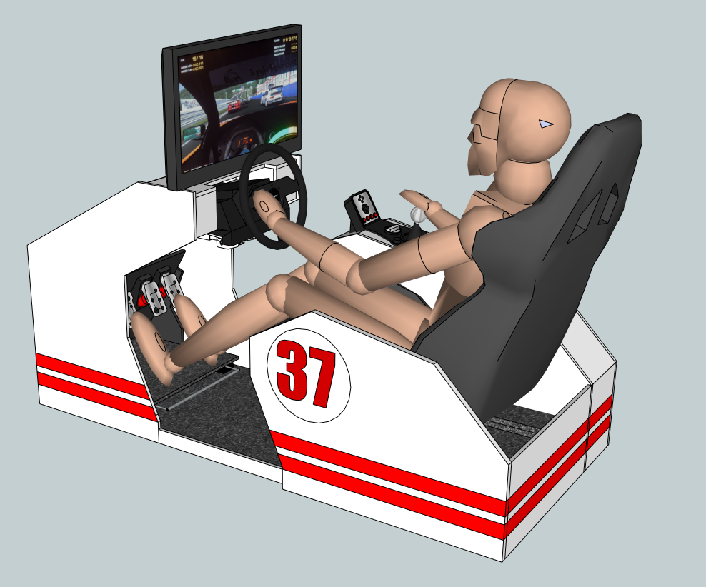

Hi, I'm a car racing fan and thinking about to make my own sim cockpit a long time.
So I started looking for a racing seat to use, but one day I wonder why buy if I can make it.
Google for a while and found this site http://kit-car.org/ with this seat template http://kit-car.org/Files/Buggy/Seat.pdf
I made few adjustments like the bottom seat belt holes and joined all parts to cut all template from one metal sheet.

Step 1: Frame
Start printing the seat template in real scale. I used A4 sheets glued them all together and cut.
Next use the template on top of metal sheet and scratch the line.
Using a circular saw and a jig saw, for rounded lines, cut the metal sheet. For seat belt holes use a drill to make a hole then use the jig saw.
Now just bend and weld and the frame is ready.
Tip: If you don't have a machine to bend the metal sheet you can make a little cut ~2mm with the circular saw on the outside of the bend line, then use the bench border and press the metal. the cut will help you to bend straight lines.
