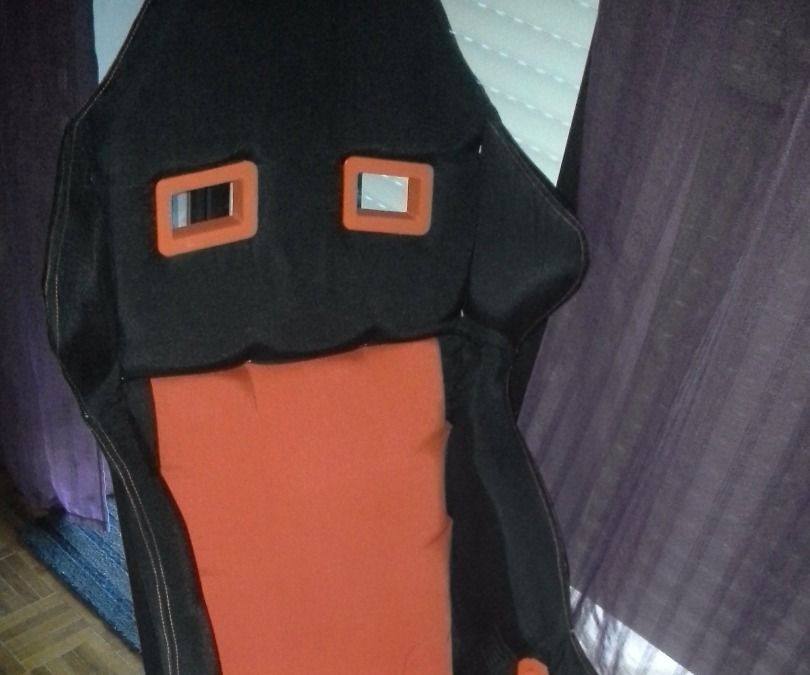

Introduction: Sim Cockpit
After the previous instructable Bucket racing seat is time to build the cockpit to put it.
Looking for several ideas and mainly inspired by R-Pod, I started by sketchup it to visualize measures and make the necessary adjustments.
