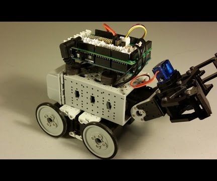

Next we will attach the Arduino microcontroller. There are two ways to do this. I wanted to be able to easily mount and dismount my Arduino and DynamixShield so I could swap it between different projects. To do this I bought some round magnets and drilled holes in the center of them as shown in figure one. I drilled a hole for a bolt, and then partially drilled a larger hole for the head to go in and be flush with the edge of the magnet. I was then able to attach this to the Arduino using four standoffs that came with the Workbench. Then I did something similar on the workbench. I used a magnet on top and one on bottom and bolted them on with a M3 x 10mm bolt. This allowed me to just plop the magnets attached to the Arduino down to the magnets on the workbench to quickly secure it temporarily. If you want to do this then you will also need to purchase the magents and larger M3 bolts.
If you would like it to be more secured than this then you simply need to use the stand-offs and M3x6mm bolts that come with the Workbench to secure the Arduino and DynamixShield to the Workbench.
