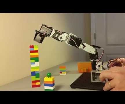

In this instructable I will show you how to quickly and easily build a remote control gripper robot using and Arduino Zero and a DynamixShield. The DynamixShield is a new add-on for either the Arduino Due, Zero, or Mega that I am promoting for my kickstarter campaign. It is a really cool shield that performs level shifting for the newer 3.3 volt Arduino systems. It has numerous, modular Grove connectors to allow you to quickly plug-in different grove sensors and motors. It also has standard three-pin connectors for analog, digitial, and pulse width modulation signals, making it easy to use with standard servos. Best of all though, is that it has a built in controller for Dynamixel smart servos. This allows you to control Dynamixel AX, MX, and XL servos directly from the shield. When you combine this with the grove modules, it becomes easy to build complicated robots with just 3 or 4 connections.
n this instructable I will use the DynamixShield to control a rolling gripper robot. The core of the frame will be made from Bioloid components and Dynamixel AX-12 motors. This robot was designed based on the probing robot instructions from Robotis, the makers of the Bioloid frames. So a lot of the initial steps are the same as in their guide. However, I have modified their design a good bit. One the bigger modifications is the gripper that is used. They build a gripper with three more Dynamixel servos and other frame parts. I originally built it this way, but it was so front heavy that it would fall over every time I tried to pick anything up. So instead, I switched it out to use the RobotGeek gripper instead. It was cheaper and lighter. The gripper can be moved up and down with a wrist, and opened and closed to pick things up and carry them. The robot will be controlled wirelessly through a XBee grove module and a XBee Commander joystick. So lets get to building!
