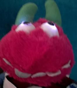

Step 3: Eyes
Let's start with something easy. We're using 2 x tri colour LEDs, the microprocessor, a 50 ohm resistor and some wires.
The red leg is connected to pin 5, green to pin 6 and blue to pin 9. The negative leg is connected to ground via a 50 ohm resistor. The brightness is controlled by the Arduino using pulse width modulation. Having separate pins means that a wide range of colours can be created.
Here's a few comments on the code.
The void eyes routine uses analogWrite to send pulses (Pulse Width Modulation) to the LEDs depending on the values of the integers r, g and b. In turn, the LEDs switch on.
void rollseye uses three for loops to change the values of r, g and b to produce a range of colours
void setup defines pins 5, 6 and 9 as outputs
void loop is the main code which calls the rollseyes routine repeatedly
His eyes look better in real life than in the video.

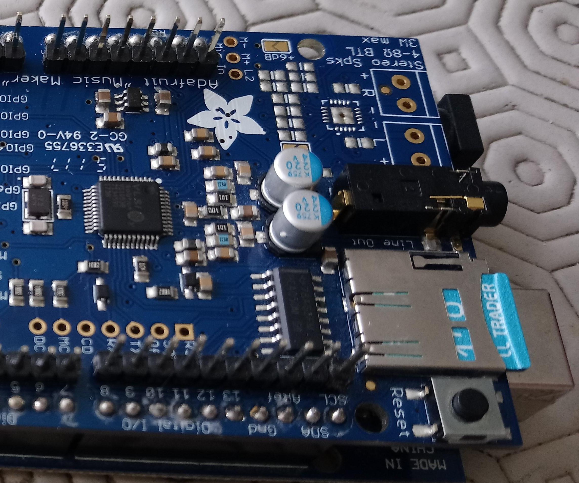

Step 4: Sounds
The Adafruit Sound board is a good thing, but relatively expensive at around £20, and they only hold about 10 sounds. Check the link below for heaps of info about it.
https://www.adafruit.com/product/2133
If you're not going the fully loaded Bobbs route, the board will work without a microprocessor, but you'll have to play the sounds using the trigger pins. Either way, it's time to break out the amp and speakers.
You can run this by setting up to 10 triggers, or by serial communication with the Software Serial library (settle down haters). I'm going to be describing the Software Serial (UART) method below. I accept there are issues with it but nothing that'll affect us here.
I'm not going to repeat the detailed instructions on the Adafruit site, but in brief;
Firstly, find some sounds to copy onto the board. Soundbible's a good place to start
http://soundbible.com/
Download them and convert to OGG or WAV if necessary. The board doesn't use MP3 format but converting the files is easy. I like the Audacity application as you can edit the file to get exactly the noise you want.
https://www.audacityteam.org/
The files will need to be named T00, T01, etc
Next transfer them to the board using a USB lead. That's the set up done
Installation. Pins 7 (RX) and 8 (TX) go to TX and RX on the Adafruit FX board. Connect the UG pin to ground to enable UART mode. Also connect up the amp, speaker and power.
Bobbs has his speakers positioned just behind his mouth.
The code. Adafruit have their own libraries which I haven't used but expect they're good. I've written my own for Bobbs
