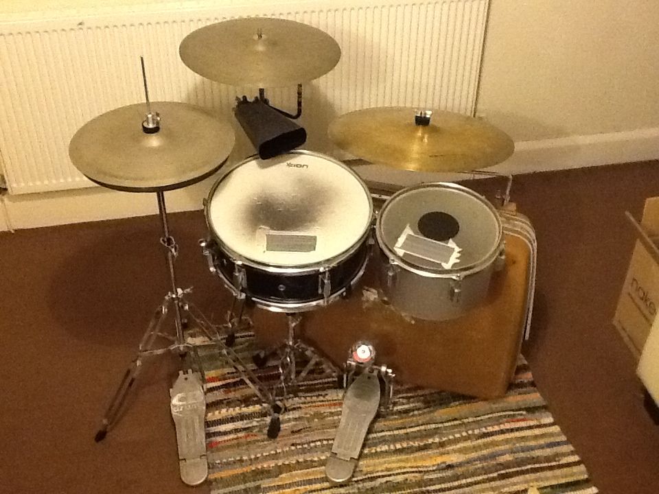

To attach the floor tom leg mounts, drill two holes in the side of the suitcase as shown in the pictures and bolt it up. I installed two on this suitcase, but have installed as many as four on previous models.
I mounted a cowbell on one cymbal mount, and used a cymbal stand to hold an old ride cymbal. I found this ride in the garbage. Its brand name is awesome, "KRUT"!
Get creative and think other types of mounts and accessories to personalize your kit.
To use the floor tom leg mounts just measure and drill holes on the side of the suitcase and bolt the mount on as shown in the picture.

I've included a few more pics of the completed suitcase, and some shots of the way things fit inside.
I use a towel to wrap the snare drum, and sometimes another towel to cover the cymbal and keep everything tight. I left it out of the pictures so you could see all the parts.
