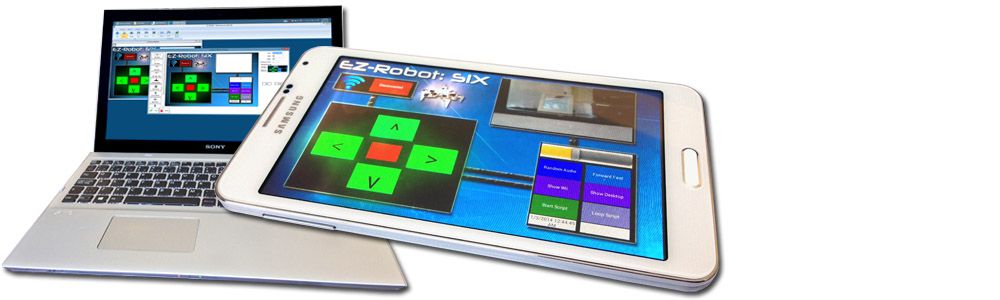

Now for the programming part... This is actually very easy. I do my programming for my robots using the EZ-Robot Project and the EZ-B Robot Controller. It does not require any programming. You can just plug in your servo motors and control the robot from your PC. It also contains voice recognition and a bunch of other neat features. You can get it here: http://www.ez-robot.com

Step 9: Circuit and Programming
This part isn't the most difficult because I am using the EZ-Robot project. It is a robot controller board that connects to your computer over bluetooth. The robot board comes with software called EZ-Builder. The software allows you to control your robot without needin to program. You can also add a bunch of other features, including voice recognition.
Here are a few links to get you started..
EZ-Builder: http://www.ez-robot.com/EZ-Builder/
Add-Ons: http://www.ez-robot.com/Add-Ons/
Form for Questions: http://www.ez-robot.com/Community/Forum
How A Servo Works: http://www.ehow.com/how-does_4970258_how-servo-motor-works.html
