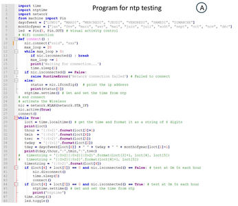

A - The ntp function, which connects to the Internet to retrieve GMT time. This function is the basis of our alarm clock. You can modify the software to familiarize ourselves with this function ("Test ntp" folder).

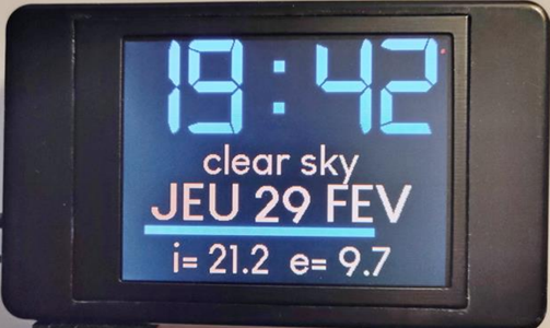

Step 5: Alarm Clock Based on Pico + 2.8i TFT Diplay
With the experience we've gained now behind us, let's move on to assembling the alarm clock with a 2.8" TFT display.
Various hardware and software improvements were made during assembly.
The temperature sensor was replaced by a more compact MF52 thermistor.
This application is stored in the "pico ST7789" folder.

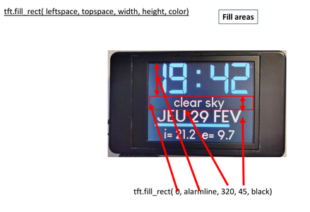

Some details:
For display control, above screenshots explain some functions For other functions, simply explore the "st7789.py" file.
The alarm function and the " cloud cover" function share the same zone.

The alarm clock operates in day/night mode, alternating the color of the information to be more discreet at night. You can find out how to change the brightness in the program and memorize the associated value, which will be retrieved when the alarm clock is restarted.
The weather function is called every 5 minutes to keep within the range of free from charge requests (<1400/day).
A progress bar shows the seconds.
