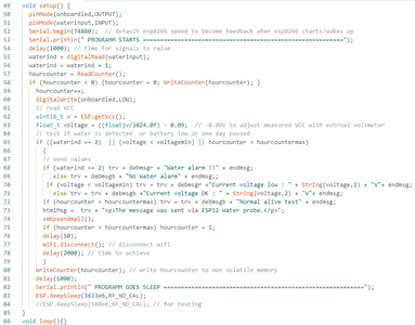

The battery level is checked by an internal controller function (see program).

During operation, the programme is started by the presence of water or after the "deep sleep" period, which is set at 1 hour.
The programme checks for the presence of water (pin 5) and/or the voltage of the power supply and/or whether the hour counter has been exceeded (24 hours in our case).
In all three cases, if a limit is reached, the programme sends the information by activating the WiFi.

Deep sleep and timer
The maximum duration of a deep sleep state on the ESP12F is 71 minutes. For the programme it is set to 60 minutes (slightly more).
A counter (hourcounter) is incremented every time the controller wakes up, i.e. every hour. The value is then stored in the controller's non-volatile memory to be read again the next time the controller wakes up.
When the counter reaches value 24, the Wifi connection is started, and the information is sent.
This daily reading ensures that the device is still working.
Serial port speed
It is set to 74880 (like is the Arduino console port) to match the default speed at controller start-up. System start-up errors are then readable (messages before program start-up).

Added functions
TestCurrentTime queries a web site to find the date and time.
WriteCounter writes the hour counter value to non-volatile memory.
ReadCounter reads the hour counter value from non-volatile memory.
Specific ESP APIs: ESP.rtcUserMemoryWrite, ESP.rtcUserMemoryRead, ESP.getVcc are used to store the hour counter and read the battery voltage.
