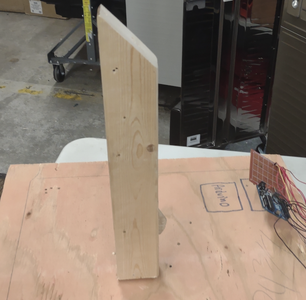

Step 6: Woodworking a Stand
Supplies:
  • Large Screw
  • Wooden Stand Piece
Tools:
  • A Drill
  • Sandpaper
  • Miter Saw (or other cutting device)
Sub-Steps:
  1. Begin by determining what angle you may want the stand sides (that will be connecting to the stand and laying on the ground) to be to meet the angle and position your target will be at. Our group used a flat end that would connect to the board and about a 45 degree angle side that would lay on the ground.
  2. Use a miter saw (or other cutting device) to cut the sides of the stand to your preferred angle. Make sure to test the stand to ensure that it fits well and meets your ideal height.
  3. Once the stand is cut, you can sand the sides that were cut to smooth the edges!
  4. Find a screw that will be able to go through your stand and into your board, ideally not through the target board though.
  5. Then determine an angle that you can drill in the screw and drill it in!
