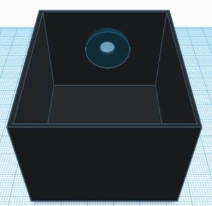

Now, secure the lens to the inside of the box, lined up with the existing hole, using glue. Don't worry if the lens is much larger than the hole; as long as it fits inside the box, and you can align the center of your lens with the center of the hole, you'll be fine. In the next step, we'll find the lens' focal point and build a simple screen inside the camera.
Since my local DAISO only had a handheld reading lens in stock, I used that and built a fancy little cardboard carriage for it. Anything works, as long as it holds the lens parallel to and aligned with the box's existing hole.

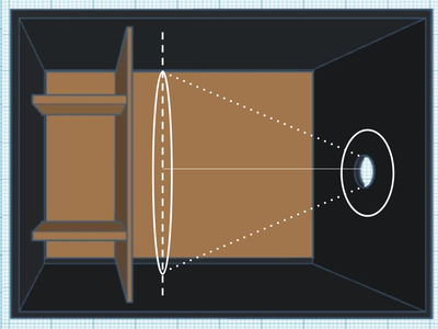

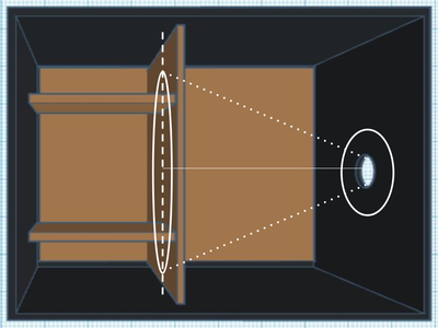

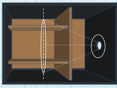

First three images above: a screen precisely the right distance from the lens, resulting in a crisp, focused image; a screen slightly too far away from the lens, resulting in a blurry image; a screen slightly too close to the lens, resulting in a blurry image.
Find a dimly lit room with a window, desk lamp, or other point light source to make this step easier. With your lens firmly secured in the drawer-half of the box (as per the previous step), point the hole toward the light source. You should see a fuzzy image appear on the far end of the box.
Take a piece of paper and hold it parallel to the projected image. This is your test screen. Move it slowly toward the lens; you should see the image become more sharp. At a certain point, moving the screen any closer to the lens will start to make the image blurry again. Go back to the distance from the lens where your image is sharpest, and make a note of this distance. This is how far away you'll need to build your screen.
Here's a video I made to roughly demonstrate what I describe in the paragraph above.

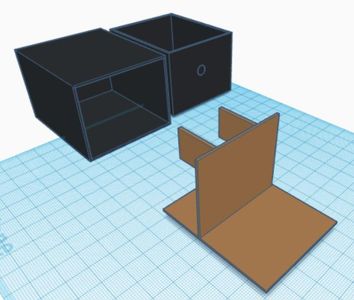

Building the screen is a pretty simple process; all you need is cardboard and glue. I cut a cardboard rectangle to the same size as the base of the box, then another about the height of the box, and glued the second perpendicular to the first at the distance from the lens noted in the previous step. I added some smaller pieces for support, and ribbon to help me pull the assembly out of the box (though the latter proved to be unnecessary).

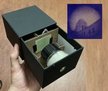

That's all there is to it! We now have one or several small pieces of custom cyanotype "sheet film". I usually secure a piece to my screen (yellow side facing out toward the world) with some small pieces of painter's tape.
Step 4: Take Photos!
Now all that's left is to point the camera towards a light source to double check that an image is projected where we placed the paper, then close the box and point it at an image we hope to capture! Usually it takes at least 45 minutes to get an image on a sunny day. Since cyanotype is sensitive to ultraviolet light, outdoor light is usually preferable. There's no need to develop the sheets once you've shot on them-- they'll come out done and a beautiful blue.
