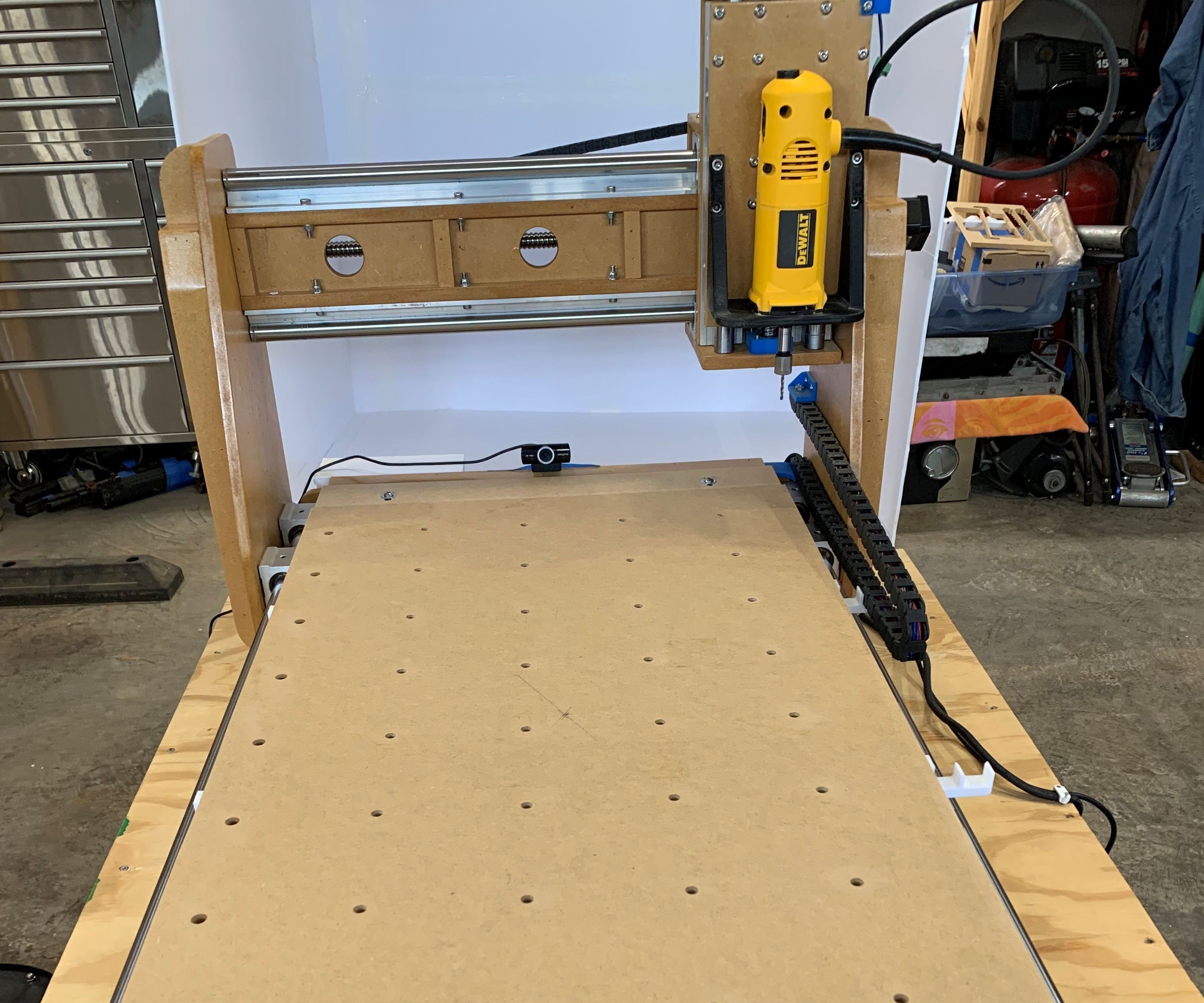

Again as I mentioned earlier I used my CNC I built, pictured above, to mill these flags. The first one is 4" high the second is 10" high and the third is 8" high. All with the same model design, tools and the same regenerated tool paths. The second and third flags I just added a US Marine logo. I have also included the Fusion 360 file too, so you can experiment with or use it!
