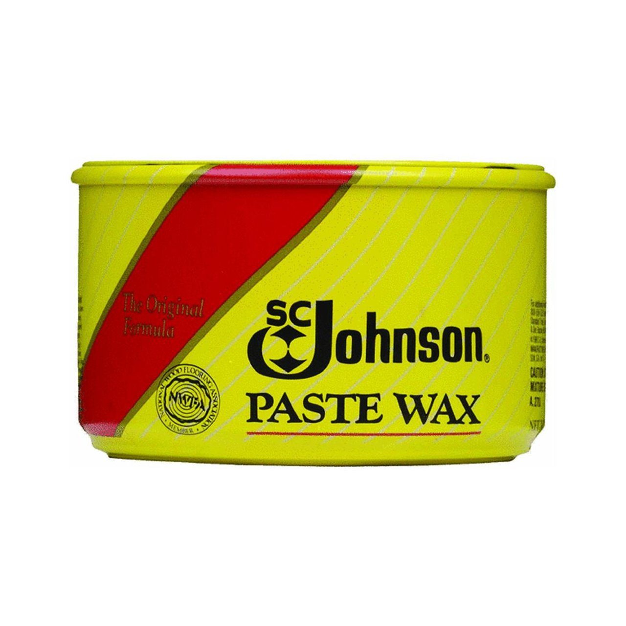

On the recommendation of a more knowledgeable friend, I used Johnson Paste Wax to try and further protect the aluminum from scratches and water. If you have some around and want to try this, be warned that it does detract from the metallic shine.
