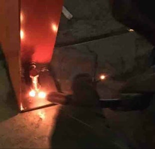

Step 6: Drain 4
James used the piece of metal I cut out from the "Drain 1 step" as the base for the drain. James welded the seams on the inside and outside of the drain. We tested the drain for leaks and by filling it with water, drying it off, and placing it on a clean section of the hot rolled steel. We waited for 10 or so minutes and found a couple small leaks, James patched them up with weld and we repeated the water test. It passed the second time.

Step 9: Drain 7
We flipped the hot rolled steelover and welded the bottom side of the drain.
