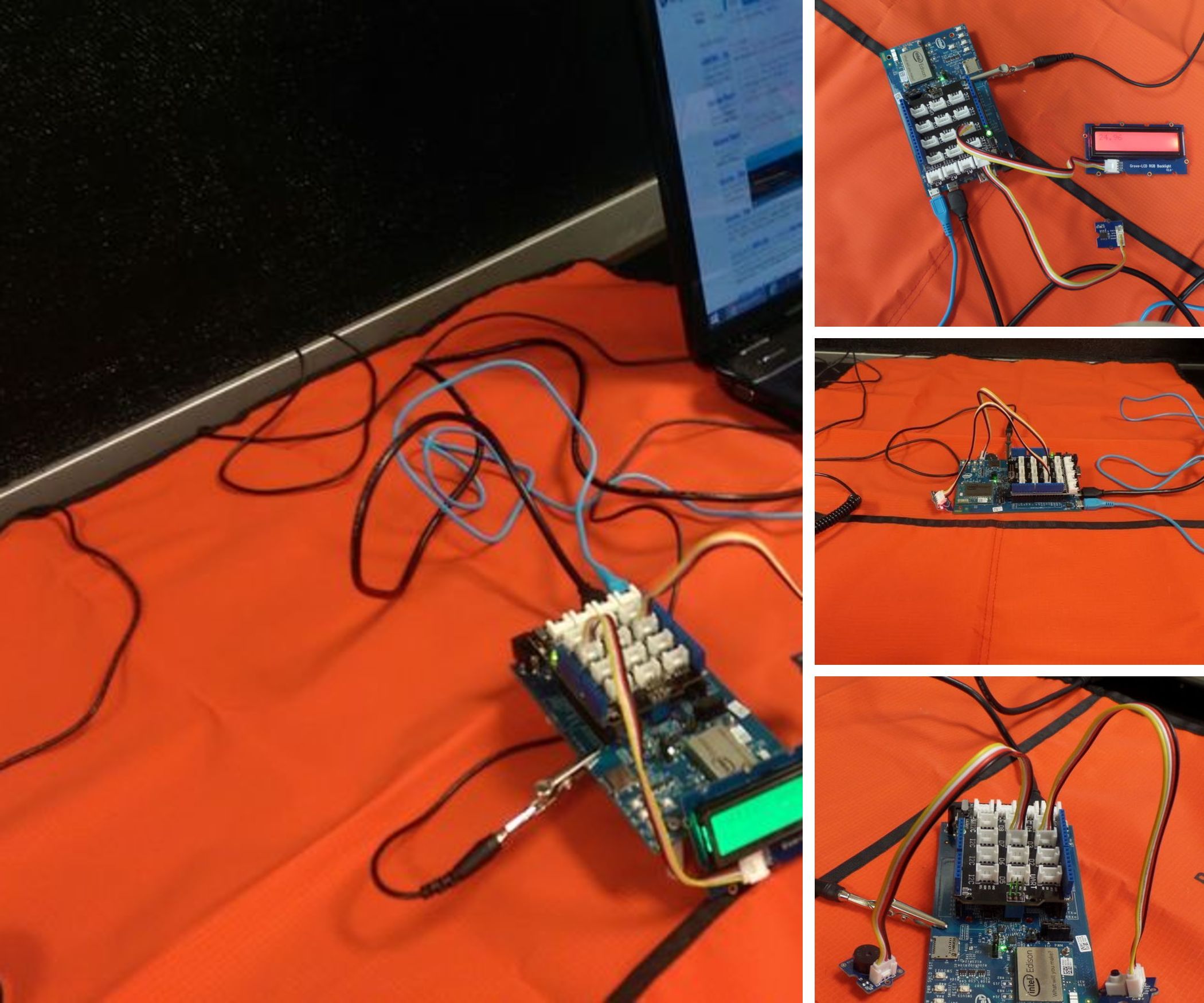

Step 1: Hardware
  • Intel Edison
  • Static Mat
  • Computer
  • 2 Mini USB Cables
  • Jumper Cable
  • Seeed RGB Backlight LCD

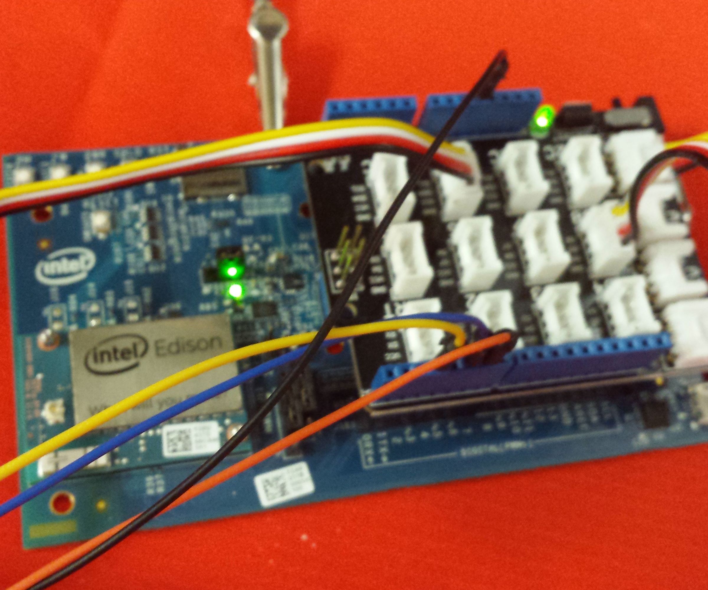

Step 2: Setup
  1. Plug your Grove base shield into your Edison.
  2. Plug jumper cable into I2C port (which one doesn’t matter). Plug other end into RGB Backlight LCD.
  3. Download code at the end of the page.
  4. Paste code into Arduino IDE.
  5. Upload the code into Edison.
  6. Play around with the scrolling text to see what you can create.
