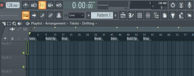

Step 5: "CREATE YOUR ARRANGEMENT"

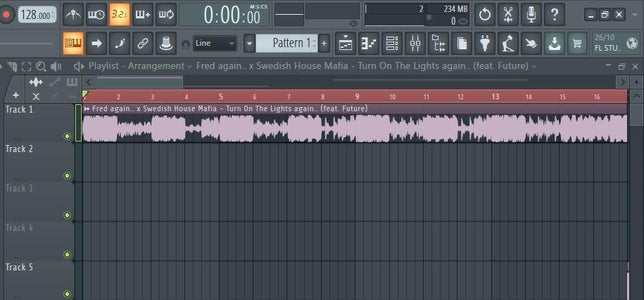

Once the arrangement is understood, we will proceed to structure our own. We will use the arrangement of the previously mentioned songs. For the intro, I will follow the structure of "Fred again.. x Swedish House Mafia - Turn On The Lights again.. (feat. Future)", and for the drop, I will follow the structure of "Tiësto - Drifting". I decided to use 128 BPM, it´s the most BPM uses in electronic music.
In the first image, we can see the first song intro, it has 16 bars. The quickest way to check the number of bars is looking the little number in red. Then, we reproduce this process with de drop of the other song. I will use time markers to establish my arrangement. You can create a new time marker by clicking in the arrow like in the third picture, add one, and selecting the bar.

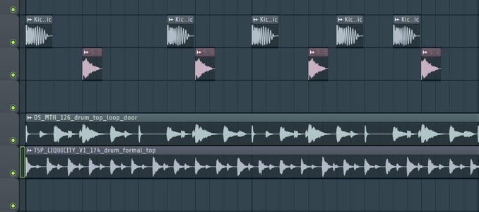

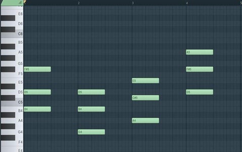

Breakbeat, like other genres of electronic music, often relies on a 4/4 time signature. In this time signature, there are four beats per measure. However, what distinguishes breakbeat is the manipulation of drum patterns within this time signature.
Instead of having a conventional drum structure with kick drums on every beat and snares on beats 2 and 4, breakbeat introduces variations and syncopation into the drum patterns. It is characterized by the use of drum breaks, which are snippets of funk or soul drum recordings manipulated to create unique rhythms.
In the first picture you can see a typical structure for the drums of breakbeat songs. It's a very simple structure. You can also add some hats, other sample drums to fill in the full drums. You can add House Hats loops, vintage hiphop drums, and everything you can think of.

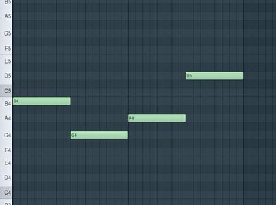

Once we have the drum created, it's time to start our bassline. For this track, I decided to use a reese-type bass, commonly used in genres like Drum and Bass, but applying a low-pass filter to create a prolonged sub-bass effect. You can find these types of basses in built-in plugins like Harmor, Sawer, and also in external alternatives like Serum, widely used in electronic music genres.
To start, we'll create a line on the same note all the time (B in this case), and then we can experiment with different melody combinations. Sometimes, simplicity works best.
Additionally, to fill in, we can add the intro's own voice, an octave higher, and create cuts in it to give it Fred Again's drop style. This cutting effect on the voice can be done with FL Studio's native plugin called GrossBeat.

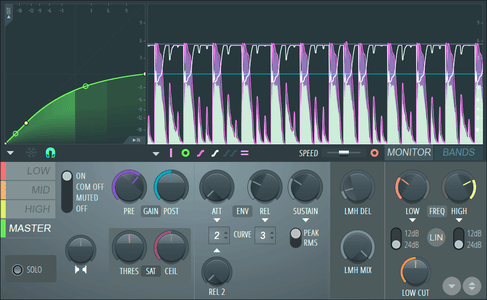

Step 14: "MIXING: COMPRESSION"

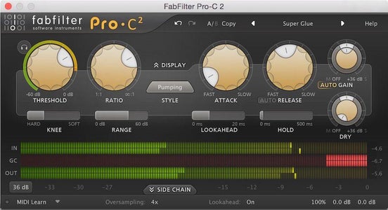

A compressor is an effect used to reduce the dynamic range. Dynamic range is the volume difference between loud and soft parts of a song, and we can reduce it by compressing the sound.
There are three main parameters in a compressor:
  1. threslhold (the volume at which the compressor operates)
  2. ratio (the compression ratio)
  3. output gain (volume increase).
Compressing louder sounds to reduce the volume difference between loud and soft can make the music easier to mix.

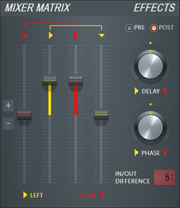

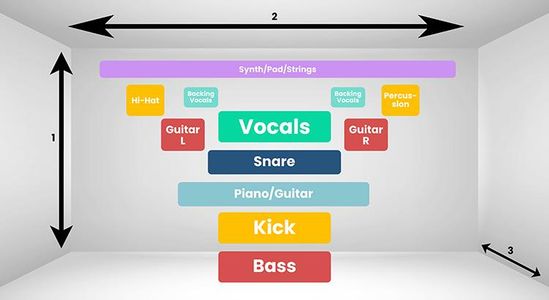

Step 15: "mIXING: PANORAMA"
Panorama is to place each sound in the soundfield. To understand panorama we must first understand the stereo sound system: two separate audio channels, each with its own speaker, R and L. Panning can create movement to the track and can add some clarity to an instrument, so you can solve some frequenzy clash.

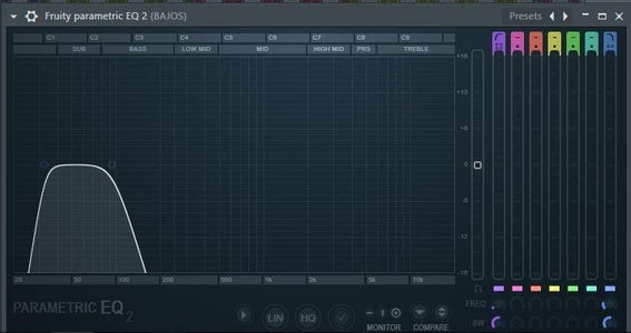

First of all, in my mastering channel, I use to open a Parametric EQ2,a fl studio native plugin, this way, we can save CPU resources, as we simply want to perform an equalization to limit the frequencies. With this plugin we can eliminate inaudible frequencies; remember that the human hearing range is between 20Hz and 20KHz. It has a preset that limit the eq between 20Hz and 18KHz, so we can choose this.

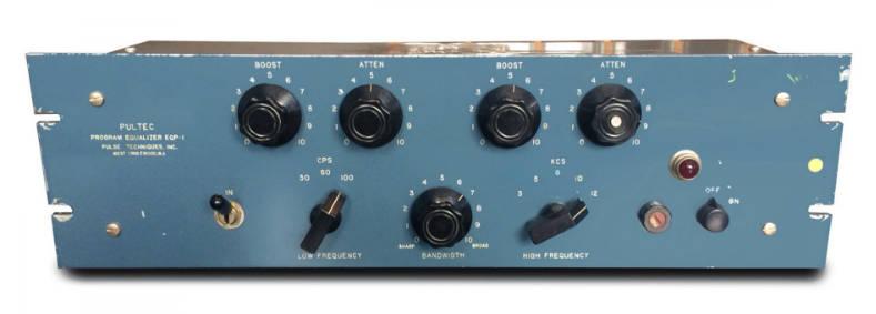

Step 18: "MASTERING: ENHANCEMENT EQUALIZATION"
For this section, we will use the emulation of a tube equalizer (PULTEC RARE). This incorporates electronic tubes in its design to provide a warm and vintage sonic coloration. These tubes add harmonic saturation, enhance frequencies, and contribute to a distinctive sound. In this plugin, we select a low frequenzy like 100Hz, and we can rise it gain with the "boost", and also attenuate a little bit this range of frequencies. We replicate this on high frequenzy, around 10/12 KHz.

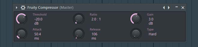

Step 19: "MASTERING: COMPRESSION"
In this section, we will reduce some parts that exceed the volume slightly, as we will perform limiting later. We aim to compress around 1 dB. This depends a bit on the song and the level of compression you want to achieve. To do this, we will set a threshold close to 0 and a ratio close to unity.

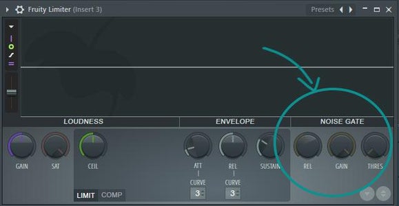

It is used to control the peak level of an audio signal. A limiter is applied to ensure that the signal's amplitude does not exceed a certain predefined threshold. It's a variation of a compressor, with many similar values.
When the audio signal reaches the threshold, it reduces the signal's gain. This helps avoid distortion and ensures that the final mix does not exceed the limits. There are many limiters, in Fl Studio, I recommend you to use Maximus, so you can save CPU resources.

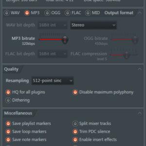

Step 25: "EXPORT YOUR SONG: PARAMETERS"
To export your song, you can do it in different formats. I recommend the WAV format, which maintains the highest quality, and MP3 at 320kbps, which is the maximum quality available in this format. As for the sample depth, it is advisable to use 24-bit int to ensure that there are plenty of samples. To finish, we only have to export our song.
