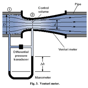

To begin, confirm that the two levels of mercury are even. If they are not, slowly open and close the two manometer drain valves until the levels are even. This is a very important step to begin our measurements for the rest of the experiment.

From the differential manometer measurement ∆h, the pressure difference can be determined.
Step 6: Analyzing Results: Flow Rate

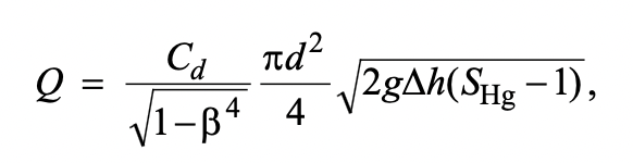

For the Venturi flowmeter, the diameter d2 is the throat diameter d, so Q can be also be expressed like this.

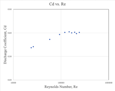

LR5) The left graph represents the discharge coefficient Cd as a function of the Reynolds number Re on a linear-log scale. As more energy is maintained in the system, Re increases.
The equation is how the Reynolds number was calculated. D is the full pipe diameter, V1 is the velocity in the pipe, and v is the viscosity calculated in LabVIEW.

1) In this procedure, the discharge coefficient Cd has a direct relationship with the Reynolds number Re until our data ended at 0.61. This is because Re is proportional to velocity and velocity is proportional to Q. The experimental value of Cd may be close to the ideal value of unity, but since inviscid flow was assumed, it cannot be perfect. To obtain more realistic values of Cd, values should be received from higher flow rates to avoid the friction developed at low rates.
