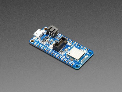

Step 1: Picking a Development Board
There are three functionalities I need for this project. The development board needs to be able to communicate via BLE, able to hook up to a GPS module, and run on a Battery for a reasonable amount of time. A quick research led me to Raspberry Pi Pico W, we can get a battery SHIM, it has built-in BLE, and runs Micropython, which means I could leverage the Python script that I found, perfect.
Unfortunately, after I got my hands on the Pico W and started developing, there's one aspect I wasn't unaware of - pairing. We need our development board to act as a central device and pair with the camera to be able to communicate with it; however, while Micropython has a BLE library, it does not support pairing (as of the writing of this, development notes are indicating that this feature will be available in the next Micropython release), so I am back to finding another suitable development board.
I came across a powerful microcontroller that does what we need - nR52840. AdaFruit has a Feather board based on this microcontroller, the Adafruit Feather nRF52840 Express. The feature-packed development board supports CircuitPythin, and has built-in BLE, a built-in Battery charging circuit, and is compatible with the Adafruit Ultimate GPS FeatherWing; it ticks all the boxes. It also has a built-in RGB LED, which we can leverage as a status light. I also picked up a 3000mha Lithium Ion Polymer Battery (the link is for 2500mAh, I got my battery from a different source).

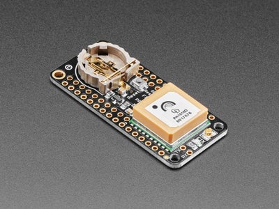

Step 3: Get Data From GPS
Now we are going to get real data from GPS; first, we need to wire it up to the Feather board. I am not stacking up the Feather and the FeatherWing because I want to keep the profile low for the final design. As a result, I am using jumper wires to make the necessary connections. Here are the pinouts to the ultimate GPS FeatherWing, at minimum, we need to connect the power pins and serial data pins.
There is no uncertainty for this part, the Adafruit instructions and example are very good, loading the following code and we started getting GPS data.

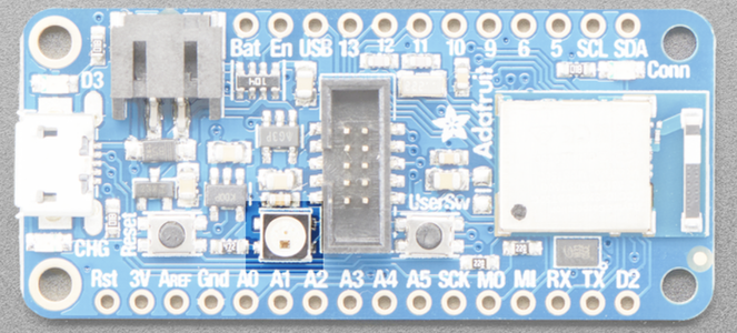

Step 4: Light It Up
Next, it's time to polish up the user experience. First, we are going to get the onboard RGB LED to work. The onboard LED is a single NeoPixel, we can manipulate its colour and brightness. neopixel.fill() is used to change the LED colour, and we can use neopixel.brightness to set how bright the LED is, from 0 being off to 1 being maximum brightness. Once we set the colour and brightness, we need to make sure to call neopixel.show() to apply the changes to the LED.

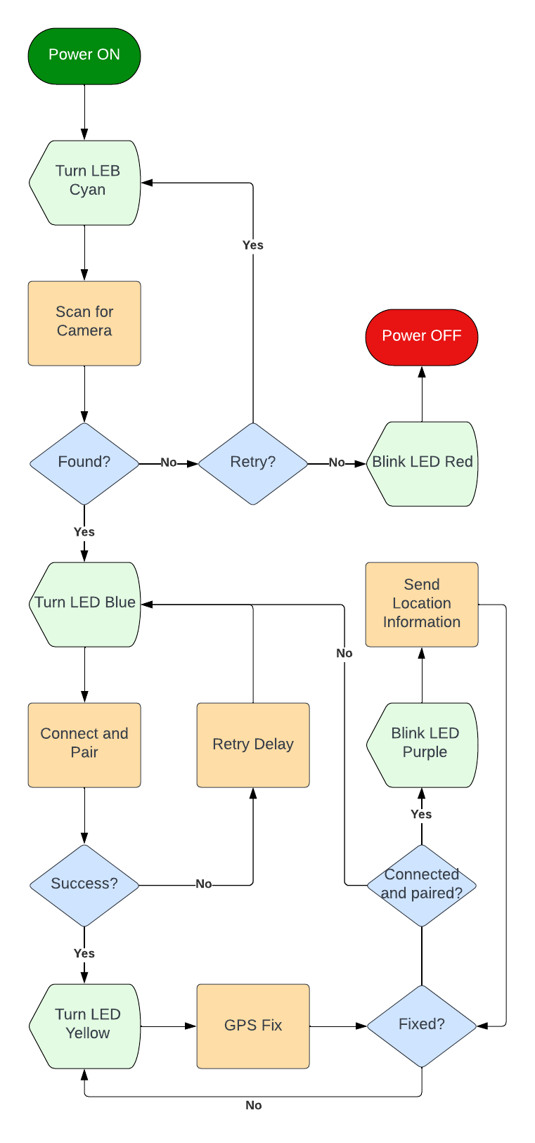

With the LED working, we can use LED to notify the user of the status of the device. The current implementation of LED control is linear with the rest of the code, meaning the traditional way of using a sleep delay to blink the LED will block the rest of the flow, hence we are only turning the LED on or off instead of blinking.
I have also implemented the retry logic so the unit would run continuously, even if the device lost connection to the camera. The whole flow is shown in the flow chart. Because the camera goes to sleep after inactivity, our device will continue to try and reconnect indefinitely. To save power, I implemented a retry delay, on the first 5 retries the delay is 1 second, and for any subsequent retries, the delay is 5 seconds. To use the device, we need to power it on when the camera is on, so the unit finds the camera. When the connection is established, we no longer need to interact with the device. The device will work in the background, connecting to the camera as it powers on or wakes up, and sends geotagging information.

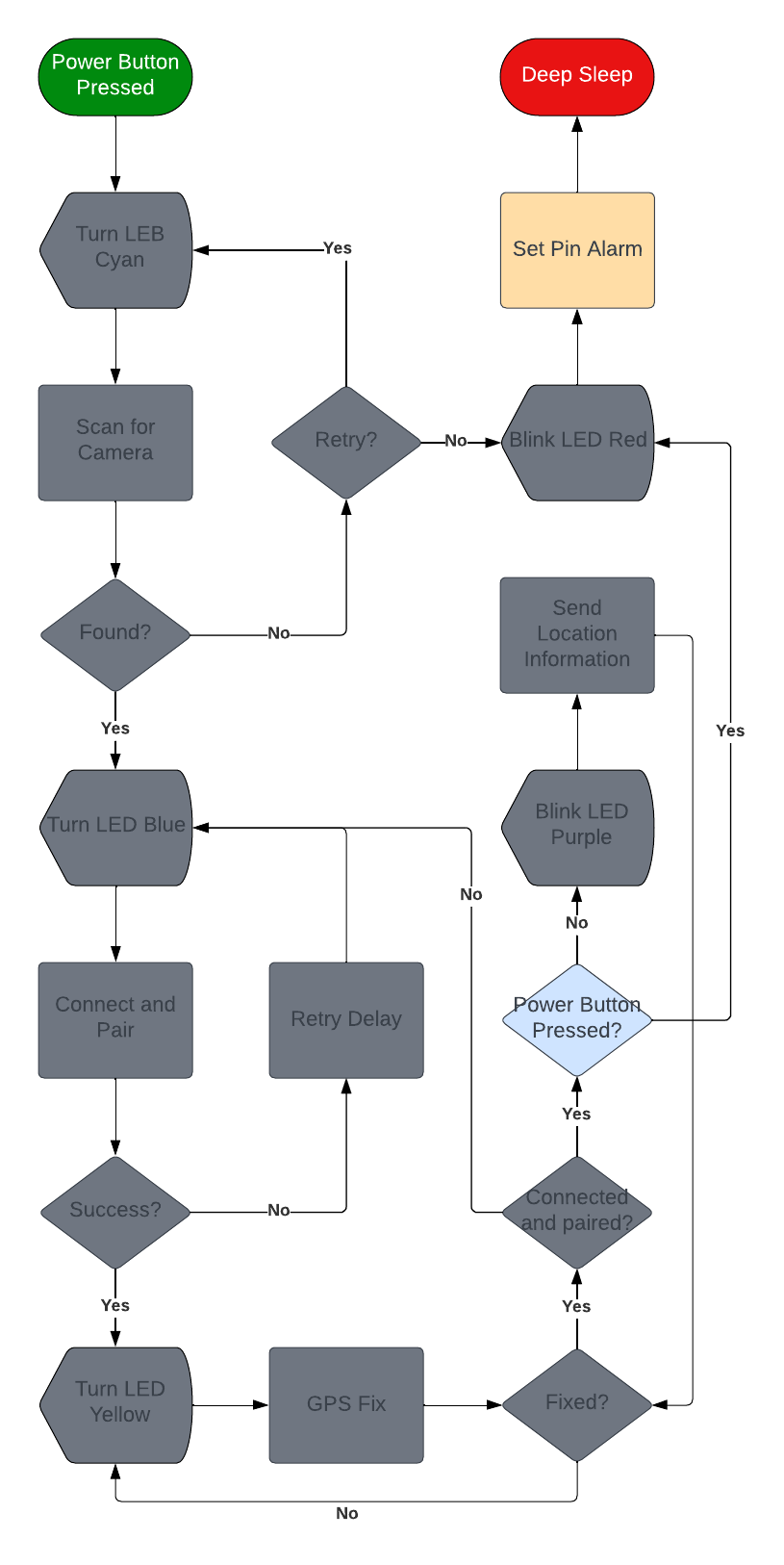

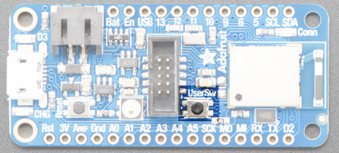

Step 6: Add a Power Button
Our development board comes with a switch we can use for this project. Unlike Arduino, CircuitPython doesn't support hardware interrupts but leverages the concept of cooperative multitasking to achieve similar behaviour, more information can be found here. The challenge with this approach is that I now need to convert/wrap all my code from the previous steps to leverage asyncio. I gave it a quick try and converting the adafruit_ble's scanning function into async generator seems to be more complicated than I thought, more research is needed. I want to get this project to a working state first before I come back and address this, so for now, we will keep the code linear.
The downside is that if the code can be blocked in a certain state, such as scanning or trying to connect to the camera. When the code is in this state, the press of the switch cannot be detected. So to send the device into the deep sleep state, we would need to press and hold the switch until we see an indication that the unit is going into deep sleep. When the device is in a blocking state, I would have to wait up to 5 seconds; but when the device is sending location information, the response is almost instant. The inconsistent behaviour is the trade-off to keep the code simple for now.
Here's the idea - when the program is sending data to the camera, it's running in a loop, this loop executes fast; at the beginning of each loop, we check if the switch is pressed. If the switch is pressed, we will initiate deep sleep. To wake up from deep sleep, before we enter deep sleep we need to set an alarm on the switch, if the switch is pressed when the board is in a deep sleep state, the alarm will wake up the board and restart the flow from the beginning.
One thing we need to pay attention to here is we cannot use the switch as an input pin and alarm pin at the same time. As a result, during the initialization phase, we will set the switch as an input pin, so we can detect it while the board is running. Before we go into deep sleep, we will detach the switch as an input pin and bind it to the alarm. In the deep sleep state, pressing the switch will wake up the board and it will go through the initialization phase again, the switch will be initialized as an input pin again.

An updated flowchart with new and modified state highlighted is attached, it shows the complete flow of our code so far.

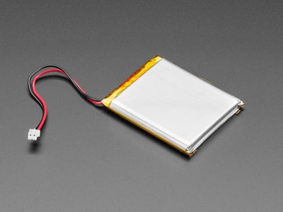

Step 7: Battery Indicator
I picked up a 3000mAh battery for this project, thinking a bigger battery would allow the device to run for longer. What I did not take into consideration when selecting the battery is the charging speed. The out-of-box charging rate of the onboard charger is 200mA, meaning it will take about 15 hours to charge our battery fully. Fortunately, it's possible to increase the charging speed to 1000mA, or 3 hours to fully charge our battery, by replacing a resistor, it's a very delicate job so we will add this to the backlog for the next revision. Now, I'd like to have a way to see how much battery I have left, and Adafruit already has this problem solved here.
