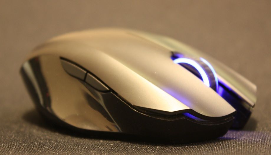

Here was 2 test shots taken with my macro lens in my office. the shots were pretty lousy I admit but it just gives an example of the highlights and how I could archive the same level of brightness at a higher shutter speed. Both shots were taken at f5.6.
Shot 1 was done in natural light with a shutter setting NR 1.6
Shot 2 I was able to bump it up to 1/8 s
