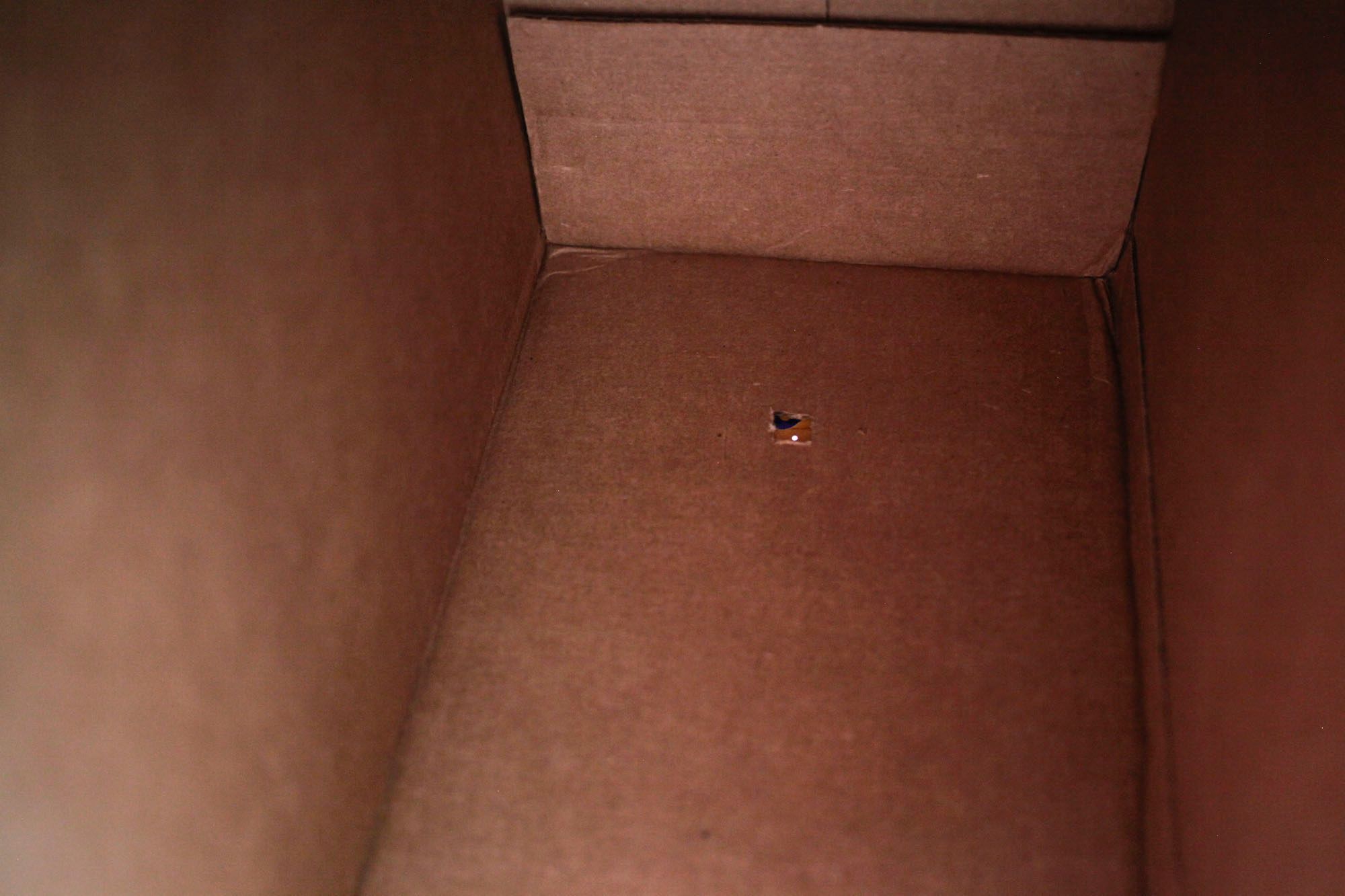

Using a thumb tack, I poked a hole a hole in the aluminum. You can see in the second picture, the hole is super teeny.

When you have the viewer on your head, you won't want any light leaks ruining your view. I was able to block all the light leaks with gaff tape, but you can use electrical tape or duct tape. Any completely opaque tape can help solve your light leaks.
In the first picture, you can see all the small gaps where the light is flooding in.
I blocked off all the corners of the box, and one of the side seams had a sizeable gap that needed to be taped over.
