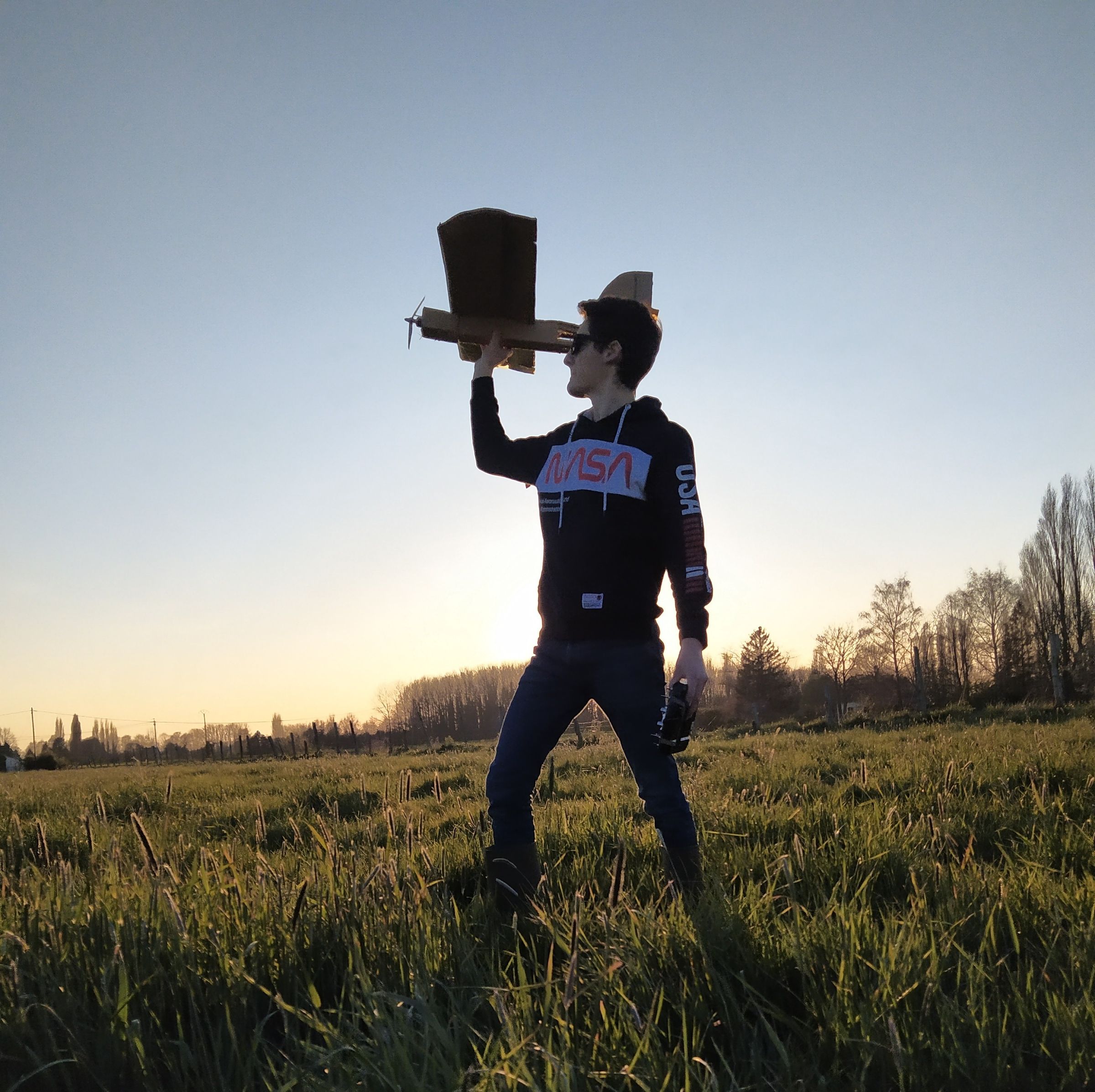

Step 8: Time to FLY !!!
BEFORE you fly I highly recommand you to train on a simulator like PICASIM. You can buy a cable (few euros) to link your radio to a computer so that you can train on a simulator. There are also few apps on smartphones.
When everything is done, you can pair your receiver with your radio and connect everything together. Each radio is different so I let you discover your own.
WARNING check every servomotor direction. Check that when you go up, your plane will go up and conversely. Same for the rudder and the ailerons.
When you feel ready, find the wind direction. You will launch your plane AGAINST the wind and land it the same direction. Put half power and launch it with a medium speed (you can ask someone else to help you). You should first try if your plane flies straight ahead. If it seems to dive, move your battery back. If it climbs quickly, remove weight on the back and move your battery forward.
You should also wear glasses to protect you from sunlight and you should ALWAYS back the sun.
It's time to ENJOYYYYY !!!!
Do not be worry if your plane crash often first. You will need to adjust plane and improve your pilot skills :p
