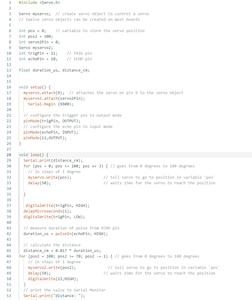

Step 6: Code
Using the coding program Arduino IDE, add the following code to the program and download it to the Arduino using a USB.
Code:
#include <Servo.h>
Servo myservo; // create servo object to control a servo
// twelve servo objects can be created on most boards
int pos = 0; // variable to store the servo position
int pos2 = 100;
int servo2Pin = 8;
Servo myservo2;
int trigPin = 11; // TRIG pin
int echoPin = 10; // ECHO pin
float duration_us, distance_cm;
void setup() {
myservo.attach(9); // attaches the servo on pin 9 to the servo object
myservo2.attach(servo2Pin);
Serial.begin (9600);
// configure the trigger pin to output mode
pinMode(trigPin, OUTPUT);
// configure the echo pin to input mode
pinMode(echoPin, INPUT);
pinMode(13,OUTPUT);
void loop() {
Serial.print(distance_cm);
for (pos = 0; pos <= 100; pos += 3) { // goes from 0 degrees to 180 degrees
// in steps of 1 degree
myservo.write(pos); // tell servo to go to position in variable 'pos'
delay(50); // waits 15ms for the servo to reach the position
digitalWrite(trigPin, HIGH);
delayMicroseconds(1);
digitalWrite(trigPin, LOW);
// measure duration of pulse from ECHO pin
duration_us = pulseIn(echoPin, HIGH);
// calculate the distance
distance_cm = 0.017 * duration_us;
for (pos2 = 100; pos2 >= 70; pos2 -= 1) { // goes from 0 degrees to 180 degrees
myservo2.write(pos2); // tell servo to go to position in variable 'pos'
digitalWrite(13,HIGH);
// print the value to Serial Monitor
Serial.print("distance: ");
Serial.println(" cm");
digitalWrite(13, LOW);
for (pos = 100; pos >= 0; pos -= 3) { // goes from 0 degrees to 180 degrees
