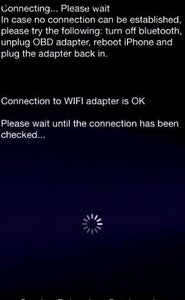

Tap the select option right of “Connection/battery” filed to connect carly bmw adapter.
Step 4:
Please wait until the connection hase been checked….
Step 5:
The connection has been established and the engine has answered.

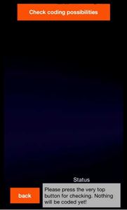

Step 6:
Please press the very top button for checking.

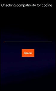

Step 7:
Checking compatibility for coding
Waitting for progress bar completing

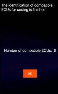

Step 8:

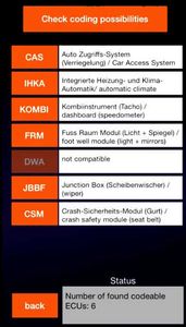

The identification of compatible ECUs for coding is finished
Number of compatible ECUs:6
Step 9:
Tap the “KOMBI” option,then press “Read out ECU”

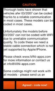

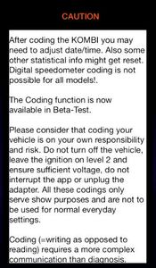

Here press “active” option to active digital speedometer,then press “Code now”
The Carly BMW will show a Caution info to you: “After coding the KOMBI you may need to adjust date/time.Also…” Scroll down to check the info,and after coding completing,follow the massage to operate. And at end of this CAUTION massage,press the button “Agreed-code now!”

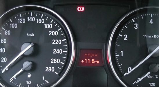

Step 15:
When coding the instrument cluster,the daily miles,among other things get reset.
