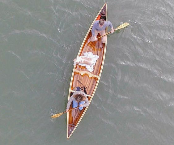

Step 12: Put It in the Water
The whole process takes several months. My best guess for the number of hours I spent on my first canoe is somewhere around 300. It cost me about $1500 but it could get way more expensive than that depending on wood accessibility and several other factors. For a project like this there are so many variables and different ways of doing things. There are more and more people posting instructional stuff for cedar strip canoes online all the time so there's really no shortage of how-to resources. I have worked really hard on my YouTube videos to make them fast paced while still providing thorough instruction - if you're interested in seeing more of an in depth description of the processes watch my videos and feel free to leave comments on them if you have feedback.
I have done a lot of woodworking but cedar strip canoes are definitely the most fun, engaging, and difficult project I have ever taken on. If anyone has the resources, time, space and drive I would highly recommend giving it a go!
