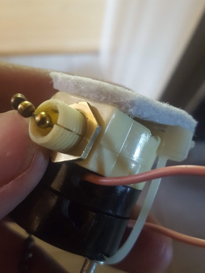

The pull chain is only to index the center contact to the next position.
There are many different pull switch varieties out there. I am going to talk about mine only. Mine is a 5 to 8 wire double layer switch. The switch has small ports to plug in wires in up to 8 places.
The way it is configured, it will grab the wire when pushed in and requires a release tool to remove the wires. A paper clip is what most instructions tell you to use. I used a small jewelers screwdriver to remove my wires. My switch is one of the 3 double layer switches that I discovered. There may be other double layer switches but this is all that I know of. Mine makes connection with three of the terminals at once in both layers.
As they say, a picture is worth a thousand words. I have taken time to disassemble my old switch to illustrate the inner workings. This should at the very least give you a good idea as to how the switches function. I bought the wrong switch for my fan and this was the beginning of my quest to solve the problem.
The one I bought was to connect 2 terminals at a time with each pull of the chain. In the end after deciding it was a last resort, I disassembled my switch and the new one that I purchased. I merged the two switches and got a good working switch. I used the new bottom half and my old top layers. They fit together perfectly. I would only recommend this as a last resort. If you do take it apart, go slow and be careful. You may wind up with junk in your hand or on the floor.
