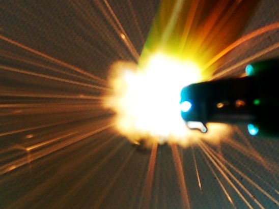

Here is a Peltier unit freezing water in 30 seconds.
Here is a mislabeled (whoops) Seebeck unit powering a motor. The thermoelectric unit generates electricity as heat passes through it from the fire to the ice water. The unit has a thin layer of thermal grease to help conductivity. It sits on a aluminum bar in ice water keeps the other side at 32F so we had a baseline. The top of the thermoelectric element is covered with metal to protect it from being scorched. It turns out we really didn't need it.
