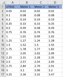

Step 3: Current Measurement Accuracy Test
This test is intended to determine how accurate these meter in measuring the current passing through them
I am going to increase the applied current using a constant DC load device in steps of 0.25 Amperes Until I reach 3.5 Amperes.
Test steps are:
  1. Increase the load current in steps of 0.25A
  2. Record the voltage reading with the used multimeter (UT61E in this case)
  3. Record the current reading displayed by each of the three meters
As you can see from the measurements table and graph, these meter are not as accurate in current measurement as they are in voltage measurement, They are also not accurate enough in the <100 mA range so you can't depend on them with microcontrollers and development boards.
