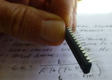

Inserting the 328P into your breadboard: To insert the 328P into your breadboard, you must bend the pins carefully so they line up with holes in the breadboard. The first picture shows how the pins on a new 328P often poke out at a slight angle and don't perfectly align with the holes in a breadboard. The second picture shows how the pins should be. They have to be bent slightly to line up. To do this, grip the chip by the edges, then place one set of pins against a hard surface and rock the chip forward to bend the pins slightly. The third and fourth pictures should give you the idea of how to do this. Repeat for the pins on the other side. Be careful so you don't bend them too far. Press the chip firmly but carefully into the breadboard. The part should go easily into the breadboard. It's all easier than it sounds, but a bit daunting the first time you do it.
The notch on the 328P package indicates Pin 1. With the notch facing your left, pin 1 is the first pin on the left closest to your body. The figure titled "Atmega 168 Pin Mapping" shows the physical pins of the 328P (same as 168) and the corresponding pins in the Arduino programming environment. I refer to this figure as the "Secret Decoder Ring". You will find yourself referring to it frequently. The diagrams and instructions to follow assume the inner red row of the breadboard is Vcc (+5 volts) and the inner blue row is Gnd (Ground or zero volts). The outer rows are not used.

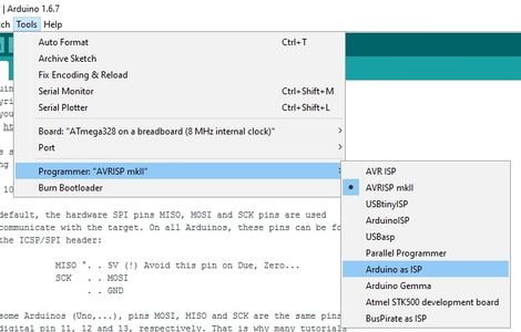

Step 5: Burn the Bootloader to the 328P
Your 328P was connected to the Uno in Step 2, so you're all ready to go. We now want to target the 328P. Go to Tools -> Board and select "ATMEGA328 on a breadboard (8MHz internal clock)".
From Tools -> Programmer, select "Arduino as ISP". DO NOT confuse this with "ArduinoISP"!! They are not the same.
Double check your settings and select Tools -> Burn Bootloader.
You should get a satisfying message from avrdude. (The "avrdude" is the programming software used by Arduino.)
