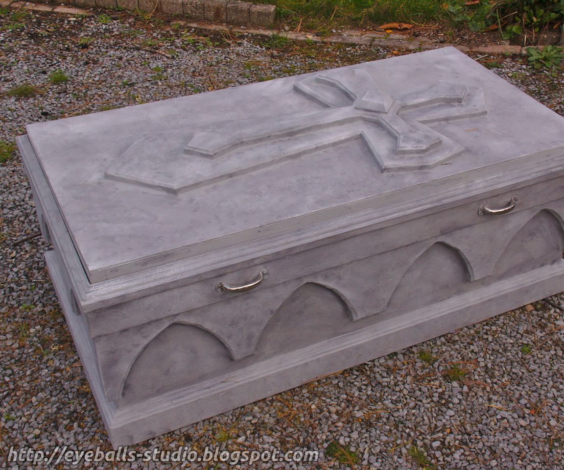

Step 4: Coating
The styrofoam is coated with a compound known as Monster Mud. This is made by mixing drywall compound and latex paint in a 5:1 ratio. To be clear, this means liquid drywall compound! If you buy powdered stuff, you have to mix it with water first. Pre-mixed compound has the advantage of keeping longer, but it's much more expensive. If you use powdered compound, don't make too much at once because it starts to harden quite fast and becomes lumpy and hard to work with.
The pictures you see are taken in my basement. Monster mud is quite messy stuff to work with!
Step 5: Painting
The basic painting is quite easy. First, the engraved text is painted black. I diluted the black paint a bit so it was easier to get it into the letters. Next, the entire surface is painted gray. When the paint is dry, I applied some spots of gray with a bit of purple mixed in, to make the base color less monotone.
Step 6: Weathering
The final step is weathering. The tombstone now looks too clean. Weathering is accomplished using a technique called "drybrushing". Don't use a new paintbrush for this, because it will ruin it. What you do is taking a little bit of undiluted paint on your brush, and then wiping most of it off again on a piece of paper. You then use the almost dry brush to apply dots or streaks. It leaves a little bit of paint on the object, but it makes a huge difference!
I started by applying some white around the text, so it stands out better. Next, the entire surface got treated with black. This made it look more like stone. If you look at the second and third picture, that's the same surface before and after drybrushing! To finish it, I mixed some green and brown paint and drybrushed this in corners, to simulate moss and dirt.
