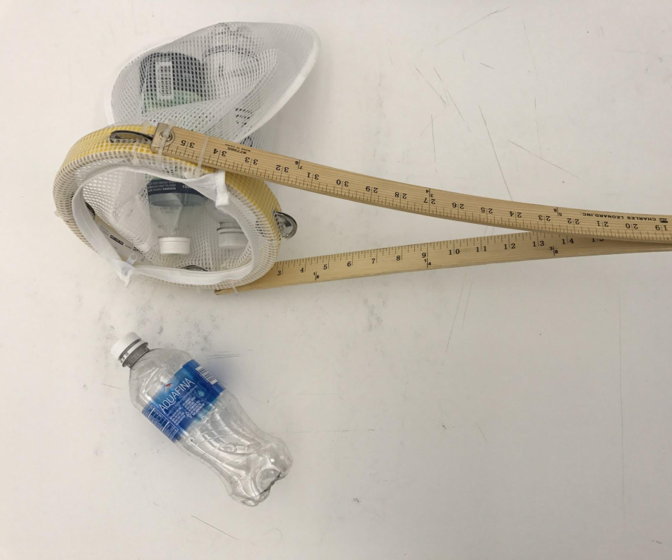

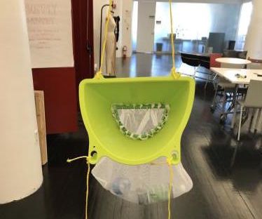

We collect our data with trawls, we invite you to test our trawls of your own. After one is done trawling it is important to process the samples to collect data.
The steps below demonstrate the simple process on how to sort organic and inorganic material.

Drain the net.
Step 4:
Flip the net inside out.
Step 5:
Let your the sample dry for 10 minutes in the net.
Step 6:
Use tweezers to pick out the samples from the net meticulously.
Step 7:
Sort the inorganic and organic material using tweezers from the net on to the 0.5mm grid paper.
