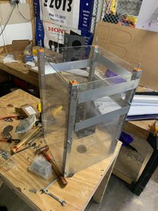

Step 2: Cut Square Out of Polycarbonate Sheet
  • Cut a 3.5 x 5 square out of the 1/4 x 14 x 24 polycarbonate sheet
  • Use the onshape document as a reference
Step 3: Make Holes in the Metal Tubing & Polycarbonate Sheets
  • Drill holes into the 1/4 x 14 x 24 polycarbonate sheets as shown in the onshape document with a 1/4 drill bit
  • Put in the 1/4-20 x 1 1/2 hex bolts
  • Screw the bolts with 1/4-20 nuts
Step 4: Attach Prize Pit
  • Super Glue the prize pit onto one of the metal tubing
  • Use the onshape document as reference
Step 5: The Frame
  • Place the print from the part studio named "between"
  • Put them on both sides of all of the 1x1 24” Metal tubing
  • Place the T-Slot slider on the all the Aluminium t-slots
  • Thread the ends of the T-slots with a 1/4 bits about a inch in.
  • Drill 1/4" holes on the metal tubing as show in the onshape document
  • Screw in the 1/4 bolts accordingly
  • Use the Onshape documents as reference

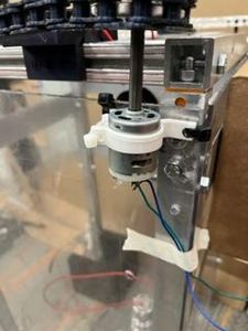

Step 6: Attach Gear Chain
  • Drill holes for motor mounting clip
  • make sure that the sprocket is leveled with the other one
  • Attach motor onto motor mounting clip
  • Repeat on both sides

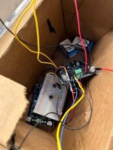

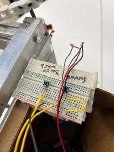

Step 8: Wiring Up the Electronics
Use the pictures above to set up your electronics
