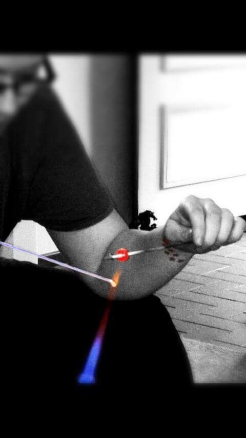

Start by 'annealing' your silver. This means carefully running the flame over it until the flame coming off it turns orange. The metal should not be red and turning molten, and with such thin wire, it's a good idea you practice how quickly this can happen. The pic shows this & I took the heat off immediately as this pic was taken.
