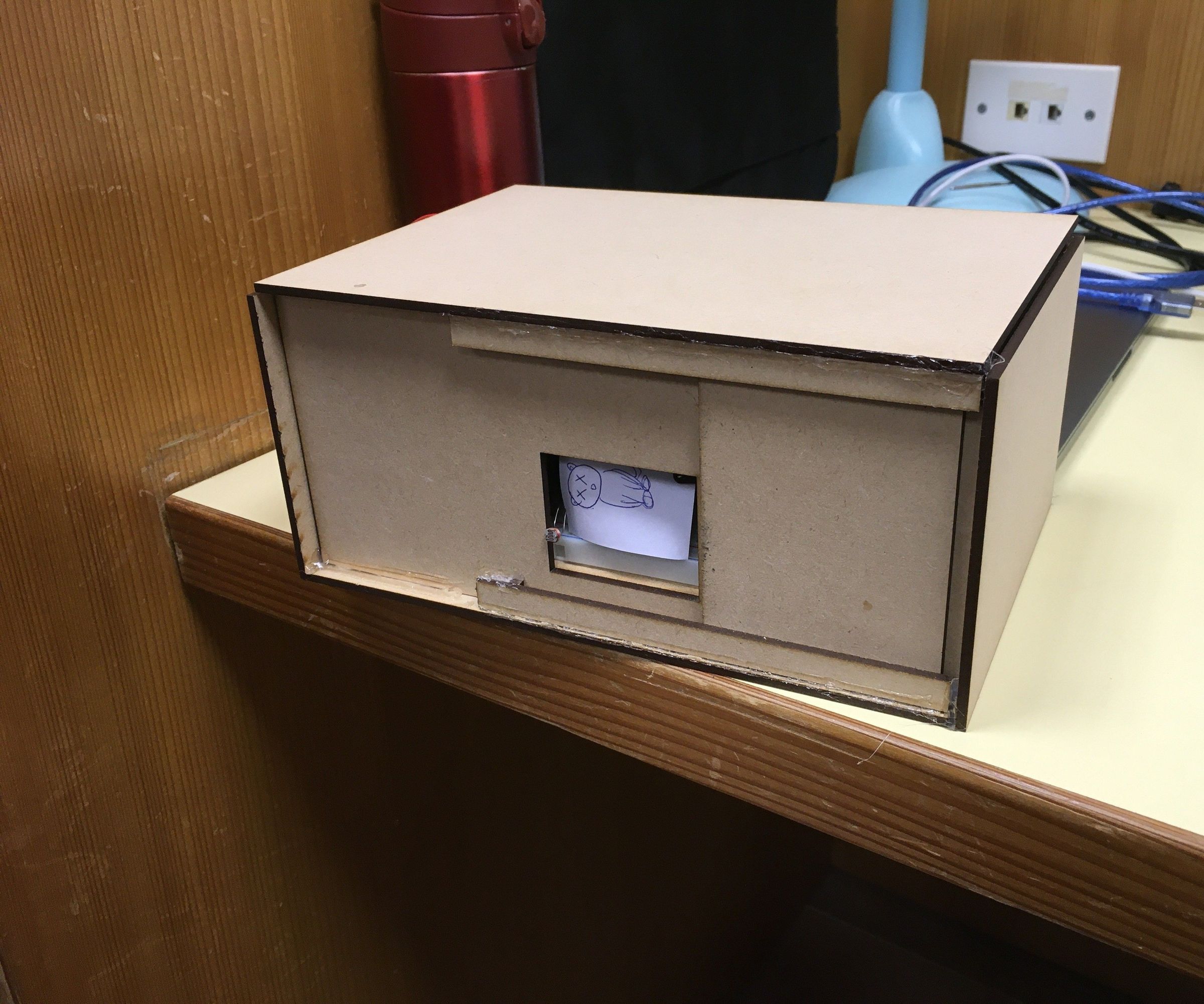

Introduction: Clock With TH Sensor and Dust Sensor Using Arduino
Hello! This topic is my reference from the Internet, I am doing some adaptation. This is a temperature and humidity clock plus a dust sensor that can be used in a studio or the like to detect the air quality around you.
I didn't do a good job in the design part. I hope everyone can create it by themselves.

For this project you need :
- Arduino Uno- 16x2 LCD with i2c module
- DS1307 RTC
- DHT11 temperature and humidity sensor
- GP2Y1014AU0F- dust sensor(air quality) sensor
- a breadboard
- some wires for connections.
