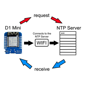

I attempt to easy explain how it works.
ESP8266 d1 mini connects to the network, then it sends request to NTP server. NTP server knows time and date and sends data to the esp8266 back. ESP8266 d1 mini receives the data.

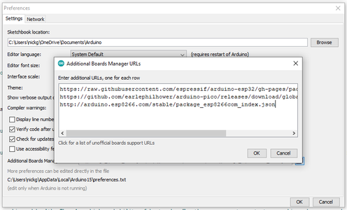

  • After Installing, navigate to File > Preferences
  • Find Additional Boards Manager URLs, and paste this link into a text field - http://arduino.esp8266.com/stable/package_esp8266com_index.json

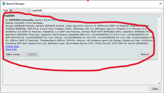

  • Then, navigate to Tools > Board: > Boards Manager
  • Type the "esp8266" in a search field, find and Install.

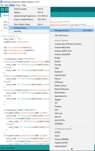

Step 4: Install Libraries
  • Navigate to Sketch > Include library > Manage Libraries;
  • Type every single library one by one and download:
  1. DHT
  2. SPI
  3. ESP8266WiFi
  4. NTPClient
  5. Adafruit_ST7735
  6. Adafruit_GFX
  7. WiFiUdp

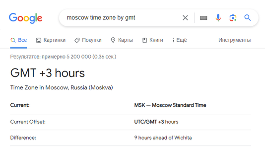

Step 6: Set the Time Zone and Time Signing
You can set your own time zone by GMT.
  • Find time zone of your city by GMT.
  • Change int GMT value to your own;
Also you can change time metric system.
There's only two metric system: AM/PM; 24Hours;
  • If you want to set 24Hours, change display_time value to "24/H";
  • But if you want to set AM/PM, change display_time value to "AM/PM";

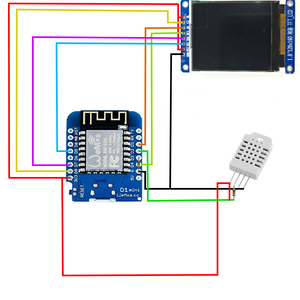

Step 7: Assemble Smart Clocks
Make sure that you rightly connected DHT22 Sensor and resistors.

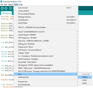

Select Board and Port to be able to upload the firmware.
  • Navigate to Tools > Board: > ESP8266 Boards > LOLIN(WEMOS) D1 mini
  • Connect GPIO0 to GND pin using 560ohm resistor.
  • Navigate to Tools > Port > Select your port;
